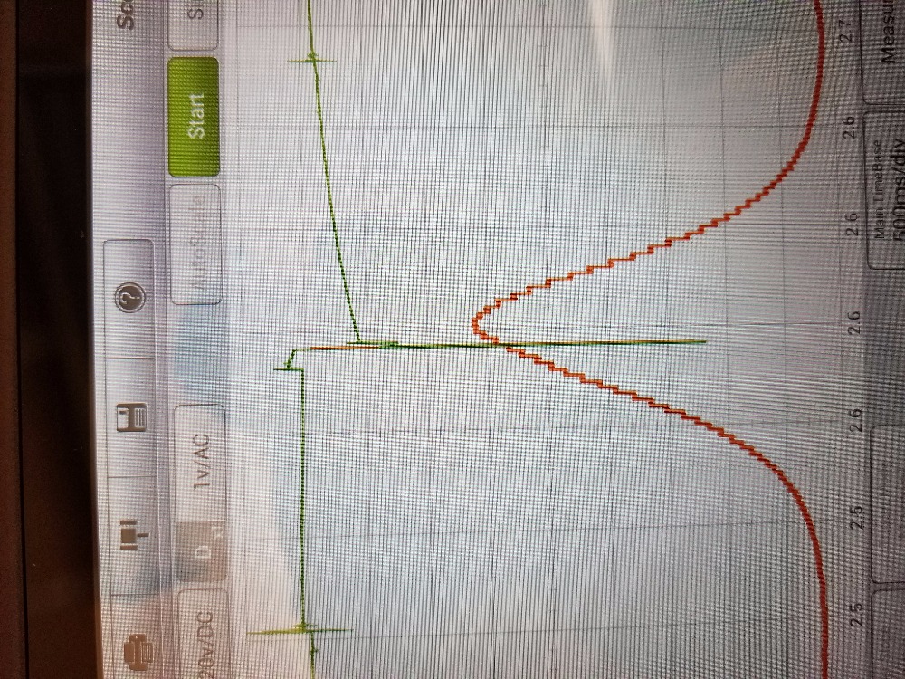

I was practicing with my scope on my truck. This is spark firing and compression with a pressure transducer.
Should the spark be occurring more toward tdc? This is cracking.
Would this be an indicator of a loose timing chain.
1996 3.0 ranger. Waste spark system.

Does the Autel scope have cursors to do time measurements? Mostly thinking about trying to measure that spark advance directly.
Finding a spec of base ignition timing on a waste spark system like this may be tough, but I'd be comfortable with around 10 degrees BTDC.

I'm thinking I can pull up the pid and compare the two. Yes it has cursors.
Ill post what I find
