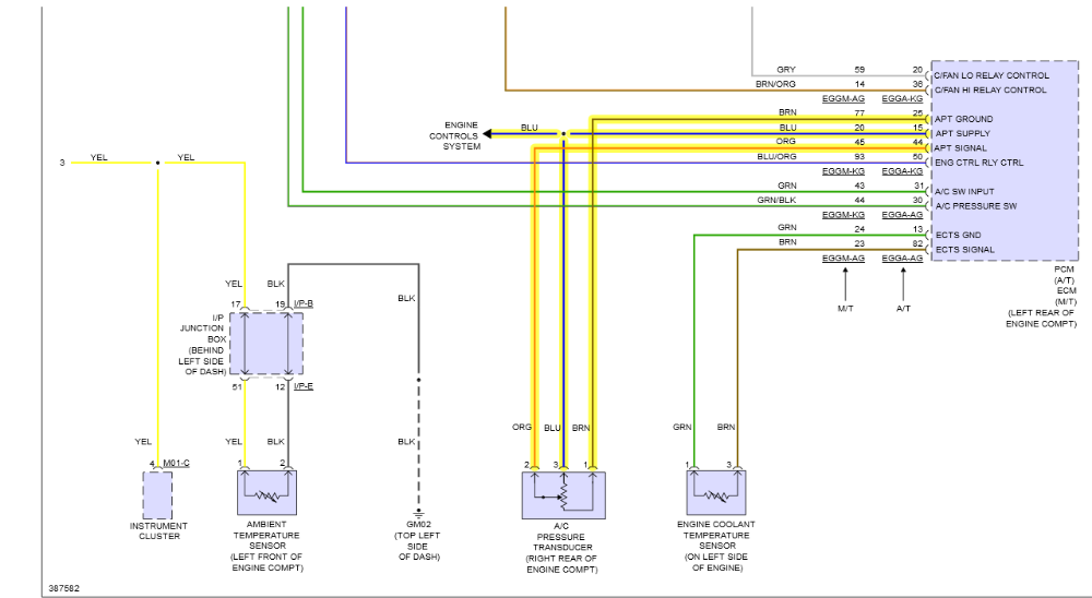

Howdy everyone I'm new here and I have a 2013 Hyundai accent gls with a 1.6l engine. Well the issue I have is the a/c is barely cold Durning the day but at night is ice cold, and by barely cold maybe not even cold but more hot and humid at times. I live in Arizona, so it's pretty hot in the summer here, I have replaced the compressor, desiccant bag because it's built into the condenser, and expansion valve. No leaks on the refrigerant and was vacuumed it down for 45 mins and it held vacuum for 30 mins with no change and it was properly charged with r134a. I'm just trying to figure out what is causing my a/c to not work during the day.

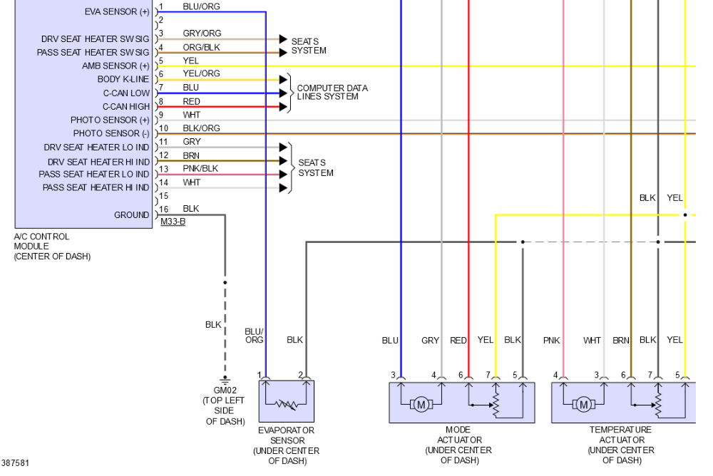

I've kinda done some research and just trying to verify but I'm not sure if this car has a evaporator temp sensor that could be faulty or where it's even located. It's hard to do checks and stuff because I'm hardly home because of my job, being an over the road truck driver.

The day/night issue is making me think the ecu is seeing an over pressure and not enaging the compressor clutch. With the AC on try checking there is 12v supplied to compressor clutch. You could check the rest pressure of the system engine off car cooled to ambient temperature with R134a this normally very close to the ambient temperature in Farenheit. The running low side - high side can be found here www.rechargeac.com chart together with a fault finding table based on pressure readings.
If the pressures are okay then try a by-pass to supply 12v to the compressor clutch --- I would probably do this by by-passing at the relay (take care to jumper the correct terminnals). If this produces cold air suspect the pressure sensor .

Also should note when it's doing the weird problem the high side acts like it's going high and shutting down then comes back to normal, cause parts diagrams and from what I've researched I'm thinking it's the evaporator temp switch and it could be faulty and it's reading like it's freezing up, but I know it's not. I'm just trying to see if I'm going in the correct direction with this

Andy.MacFadyen wrote: The day/night issue is making me think the ecu is seeing an over pressure and not enaging the compressor clutch.
I am thinking the same thing. Have you checked the pressure transducer.
Yes, it does.
