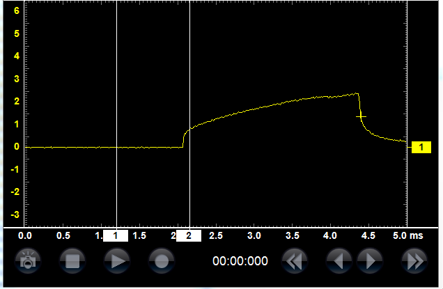

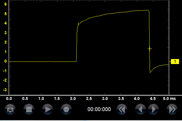

Fuel added, it idles fine. Fully warmed up, the O2 signal is stuck in the 600-700mv range. Neither vacuum leak, nor added fuel would change it. Single circuit test good. New O2 sensor. O2 activity restored. I, finally, think I'm ready to test drive! Didn't make it half way down the block before I turned around and came back. Lots of misfiring. Ramped bank 1 and bank 2 injector control from the ECM.
Going in, individually, Bank1 has 1 shorted injector and Bank 2 has 3 shorted injectors.:woohoo:
To be continued.....
