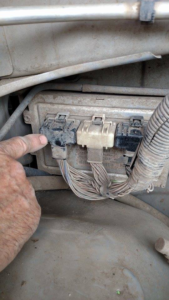

Redid code check: It is still giving just 1 code. I am reading the codes with my Autel MaxiScan MS310.
It says it is a Manufacturer specific code. I choose Chrysler for manufacturer, (Dodge is not listed).
It gives me code P1389 #D1 Chrysler "No ASD Relay Output Voltage at PCM".

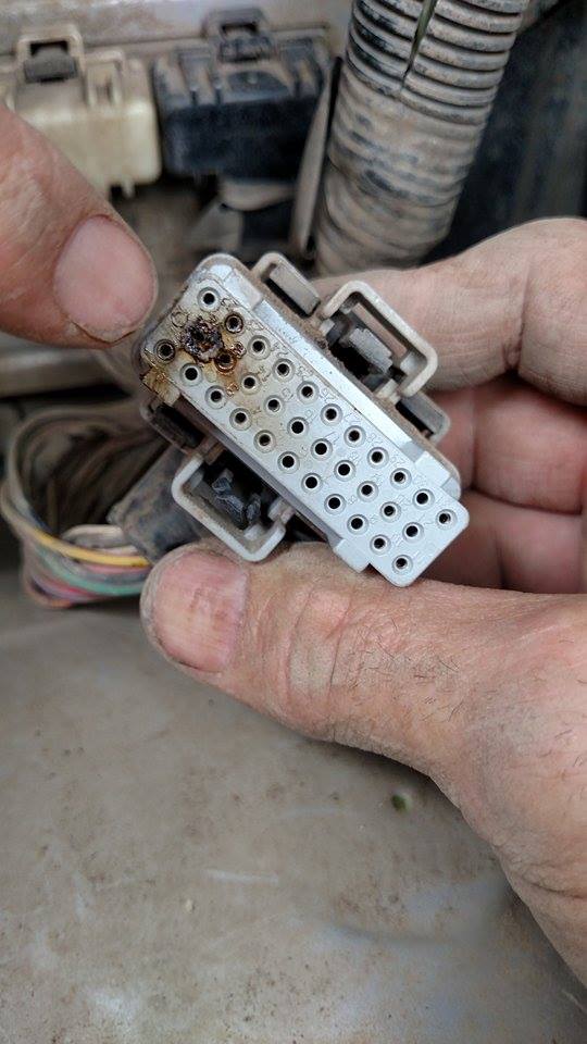

I found connector #3 on PCM. (See Photo) ..and pulled connector just to find Dark green/orange wire on Pin 12.
Here is what I found on the inside of the connector (See Photo):
Looks like pin #12 has been getting hot! :ohmy:
I went ahead and did the tests with a T-pin, backprobing the Dark Green/orange wire. Results:

10 years 2 months ago #1121 by Inge Jeppesen
Replied by Inge Jeppesen on topic 2001 Ram won't start unless you give it a drink
Looks like a loose pin creating resistance and heat. Is the pcm end also damaged from the heat?

10 years 2 months ago #1122 by Tyler
Nice photo, trat50! That was NOT what I was expecting to see, BTW.
I think I know what's going on here, but let me get on my laptop and check the wiring diagram. Unfortunately, this may end with PCM replacement and repairing that connector :(

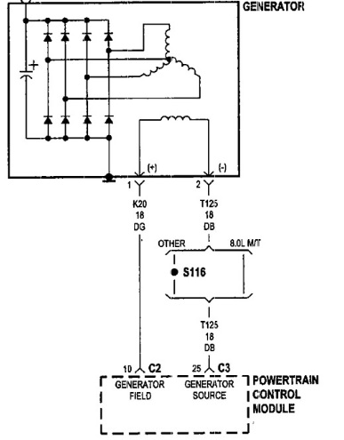

OK, did some more research. Gotta say, I honestly expected you to find no voltage at that pin. My understanding was that pin 12 was a confirmation circuit for the ASD relay, which should require zero current flow. But, the burned pin says there IS current flow there. :huh:
Thanks for rechecking that code, 'cause that came in very handy! I ran the new code through iATN, just trying to see what info I could find. I took a screen shot of a reply to a TechHelp post about our exact situation on another '01 Ram:
Now isn't that interesting? I knew the PCM controlled alternator field strength directly, but I did NOT know that pin 12 was the source. For reference, this is the alternator diagram:
Sure enough, power comes out of the PCM to the alternator (generator source) on another pin of the same connector. The PCM then grounds the generator field pin to control alternator output. I'm going over all this because I'm worried about your replacement PCM getting damaged by a fault in the alternator field circuit. I think we've found the cause of the no start, but I'm not sure we've found the cause of the PCM failure.
I'm going to look up the resistance specification for the alternator tomorrow. If you have the opportunity, I'd like you to check resistance between pin 12 and 25 of C3, key off and PCM disconnected. Also check resistance between pin 12 and ground, PCM disconnected. Note the readings and let me know what you find!

No problem! So Dodge doesn't have a very good spec for this field circuit. Service info suggests the resistance of the field winding in the alternator should be 5 ohms exactly :-/
We'll use that as a guideline, but not absolute truth.

I'm really sorry man, I told you the completely wrong wires to check. Completely my fault, got my pins mixed around, not paying enough attention. Now that I realize how I messed up, your measurements make perfect sense! Wonder if anyone else caught my mistake, lol.
Can I get you to do some new measurements? What we actually want to do is measure resistance between pin 25 of C3 and pin 10 of C2. Check the alternator diagram for reference. PCM unplugged, as always. Also check resistance to ground at pin 25. Thiso will tell us if the alternator is shorted, or if there's a short to ground on the power feed to the alternator.

10 years 1 month ago #1191 by trat50
Hi Tyler, Here are the results -
(These measurements were all done with all 3 connectors disconnected from PCM and Key Off.)
Resistance from pin 25 of C3 to pin 10 of C2:
RESULTS: 6.4 ohms
Resistance from pin 25 of C3 to ground:
RESULTS: Open circuit, no connection.

Nice, thanks sir! Those are pretty much the results I was hoping for. We now know that the power feed to the alternator isn't grounded, and that the alternator field winding isn'the shorted (for now).
Unless anyone else can find a reason not to, I think you're good to go on PCM replacement and connector repair. My biggest concern is that the alternator field winding is intermittently shorting (when hot, possibly), and could cause another failure. For that reason, I'd suggest doing an alternator at the same time.
There ARE other ways we could verify the alternator field circuit. Ohms Law says that circuit should draw around two amps when full fielded. But, to measure that, you'd either have to rig an ammeter in series, or get an inductive amp probe. This also won't rule out an intermittent problem.
Not a cheap repair, I'm sorry sir :( Plus, the replacement PCM will likely require VIN programming.

Awesome job to everyone involved! With the second person mentioning a burnt connector on a completely separate vehicle this is suggesting a common problem. If it was my truck, I would also replace the alternator but it does look more like a connector issue (resistance and heat), but hard to say.
Thanks so much trat50 for posting this here. It really helps me out a lot! And now you see why. These guys are awesome here aren't they?
