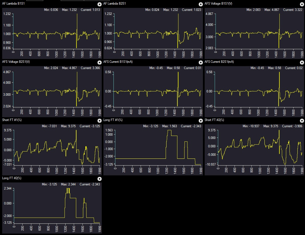

My snap on Verus never shows O2 sensor reading. I tested on Toyota Corolla and Avalon. No short term and long term data available. Any suggestion is highly appreciated.
Is Fuel Trim data available for Manual Transmission or it is only for Automatic Transmission?

Hi Karim,
The data available varies from car to car.
Depending on the year of the cars you checked and how you scanned them (obd global, or manufacturer specific), it could be labeled differently.
I don't know about Toyota, but it's not uncommon for manufacturers to use their own terms for fuel trim.
When I get messed up, I use the generic OBD Diagnose mode on the Verus.
There's fewer data pids, but the fuel trim will be displayed in a more universal layout.

As above Toyota have wideband sensors on many models

I tested on Toyota avalon 2012 without any info of my O2 sensor.
I also tested on Toyota corolla 2011 manual Transaxle without any info of o2 sensor too.

my Toyota Avalon 2012 has wideband o2 which I use Autotap to read it but my My verus 14.2 doesnt show any info of o2 sensor and fuel trim.

Hey karim! Being at 14.2 might have something to do with it. Snap-On data coverage is usually pretty weak when a make/model has only been out for a few years, and your Avalon was two years old when 14.2 came out. A newer version will likely have improved data.
Here's a shot of the data you're looking for on a 2013 4Runner with 15.2 on my Modis.
www.scanshare.io/share/9q4nK5tr8kiWgbL3Lbp1Dg#34,35,36,37

You are a life-saver. I do appreciate your help and recommendation. I now fully see that I must upgrade to the latest update.

The update isn't cheap, and I don't know about availability in your area.
Honestly, Global data has come a long way with wideband sensors, especially on newer model years. Maybe give it a look? See if it'll work for your needs.
