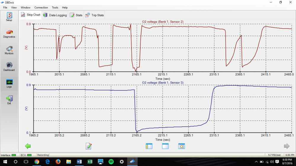

Hi,
I have an '08 Mazda 3 2.3L engine. It's giving me an engine code P0171 Lean in Bank 1 that I have been trying to diagnose. I have two scanners (a Scangauge 2 and a cheaper odb cord that hooks to the laptop - OBDWIZ) that I have been using to do my diagnosis. The freeze frame data shows that the lean code is detected at higher loads, around 50% - 60% with a long term fuel trim at around +20%. I only seem to get the code at high speeds, like on the highway, especially on hot days. Now when I monitor my o2 sensors at idle, I see that my upstream sensor is running rich for the most part with small dips to low voltage but then back up to higher voltage. My downstream sensor is steady at around 0.7 to 0.8 volts, which I believe is good. What is confusing me is that my o2 sensors are reading the mixture rich, for the most part, but the code is tell me that the mixture is lean. Is the o2 sensor detecting the adjustment that the engine is making to the engine?
I also noticed that my Manifold Absolute Pressure is at around 4.3 PSI which seems low and tells me that there is a vacuum leak. I had the car sent to two different shops and both told me that the smoke test came back negative and that there were no leaks detected. One of the shops was actually my Mazda dealer.

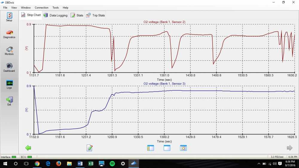

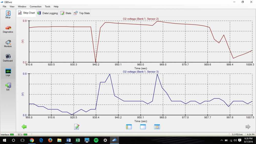

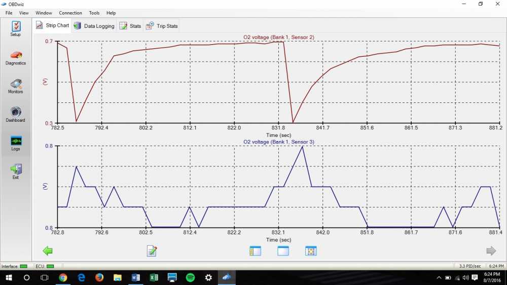

I have attached screenshots of the o2 sensor graphs.

First off, love that you've got some graphing capabilities! That'll make diagnosing this one a lot easier. A question about your OBDwiz captures: The top graph is always labeled Bank 1 Sensor 2, and the lower one Bank 1 Sensor 3. I doubt your 2.3L has two different downstream sensors, so I'm wondering if the top graph is actually the upstream sensor?
If the top graph IS the upstream sensor, then it's worth mentioning that the upstream sensor isn't a conventional O2 sensor, but a 'wideband' air/fuel ratio sensor. They don't behave like normal zirconia O2's, but the Global OBD data will show you a 'converted' value on a 0 - 1V scale. Basically, trying to make the sensor data friendly for anyone not familiar with A/F ratio sensors. Looking at the captures, I'm not sure if rich/lean is being represented correctly. Not saying I think the sensor is the problem, just trying to account for the O2 readings you're seeing.
About the MAP sensor, I'm not sure I'd read too deeply into that data PID yet. With the MAF sensor in play, the MAP isn't a load input, and shouldn't have much say on fuel trims. If you have the chance, could you take some shots of the MAP data next to the engine speed on a test drive? That'd help us check the sensor's performance.

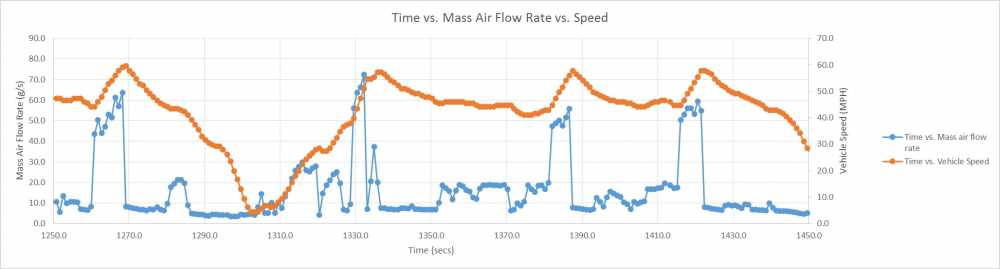

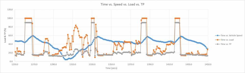

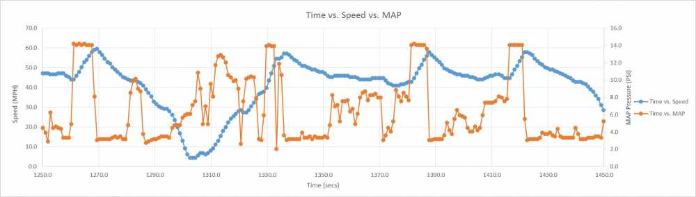

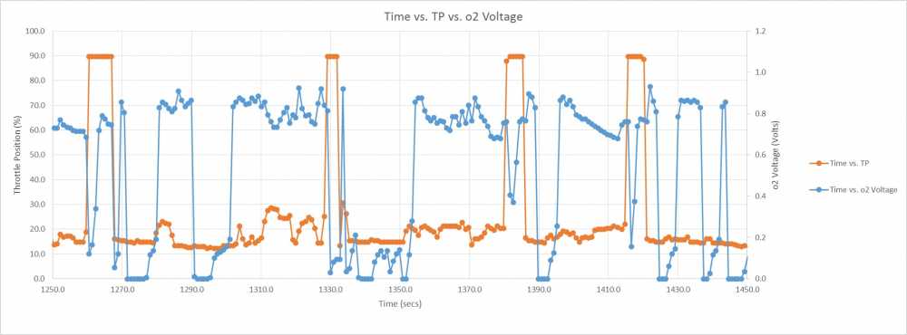

So I did a few WOT tests on a back road and recorded load %, the same o2 sensor signal (sensor 2 in OBDWIZ), MAF rate, MAP pressure, Vehicle Speed, and throttle position. I have attached a few graphs I put together from the data that was recorded. OBDWIZ has a neat feature that will record all the parameters I choose into an excel document. Unfortunately I cannot attache the excel document of the data collected due to the format.
I also have another set of data with a slightly longer pull at WOT (about 9 seconds long). That pull is not reflected in the attached graphs.
Also, when I went to collect data, I noticed that there was new engine code. I still had the P0171 but I also had a P0113 - Air Intake Temp. Circuit High Input. This gives me another reason to suspect the MAF since the IAT sensor is integrated with the MAF sensor. However, A few days ago i was playing around with my MAF sensor connector. I was trying to fit paperclips to see if I could back-probe the sensor to test it. I don't think this would have anything to do with the code since I was trying to probe the 12V and ground terminals. But I thought that this was interesting. I also cleaned the MAF sensor one more time before the run.

Hey Mazda3GT, thanks for getting back to me with the data! My sincere apologies for not getting back to you sooner.
First off, I really like the Time Vs. Speed Vs. MAP capture, as I think it shows the MAP working correctly. At WOT, the MAP swings up to slightly above 14 PSI, which is pretty close to atmospheric pressure. At idle, the reading is closer to 8 or 9 PSI, which works out to around 17 inHg, normal for a running engine in gear with some accessories on. It's confusing because the data PID reads in pressure compared to a vacuum (psi-a), instead of compared to atmospheric pressure (psi-g).
Second, I see the Load PID going to 100%, which kinda surprises me! That would tend to suggest that the MAF is working correctly, but let's not rule it out yet.

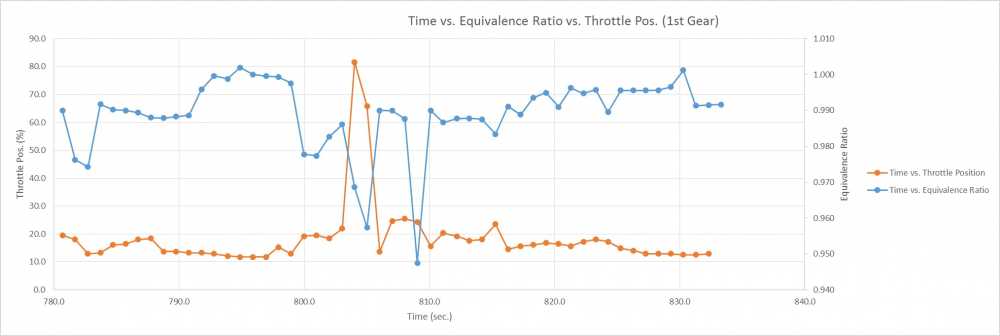

Looking at the O2 Vs. throttle position is a bit confusing. I'm still not sure that the O2 voltage PID is working correctly, or at least representing the sensor signal correctly. Any chance that there's other upstream O2 data PIDs available? I'm thinking of 'equivalence ratio', AKA lambda or air fuel ratio. That would really spell out what the sensor is reading.
The other issue is that we could really use a WOT run through first, and maybe second gear, from a stop. This will really load the fuel system, and give the data a chance to expose an issue. A run like that while watching the upstream O2 (or equivalence ratio), MAF, engine speed, and throttle position would be ideal.

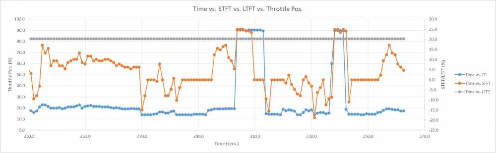

It would also be beneficial to have a look at your fuel trims during a drive. Your freeze frame indicated a Load of 50 - 60 % when the code set, so I'd be interested to see what the trims are doing around that range.

The MAP reading makes more sense now. I was worried because I saw around 4.3 psi at idle and immediately thought vacuum leak. This does make sense now. Is this almost like the difference between gage and absolute pressure?
Now that you mention it, there is a PID that is called "equivalence ratio" in OBDWIZ. I looked it up briefly and google told me that its the deviation ratio from the ideal air/fuel ratio of 14.7:1. I didn't use it previously because I didn't think it would help me. I also have a "lamba" PID and a "wide probe" PID (if I am remembering the name correctly) for both o2 sensors. Should I perform the new tests with all of those PID's for the upstream sensor? I can also throw in the short term and long term fuel trim PID's in the data.

Is it just me or did the o2 voltage kind of trend lean against the TPS voltage PID in capture 3?
I'm curious to see how the data pids Tyler mentioned check out during the WOT run. Most of the cars I see still have old zirconia sensors.

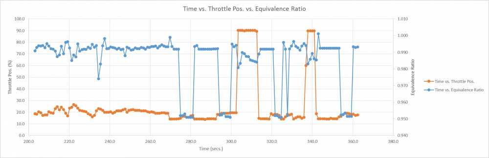

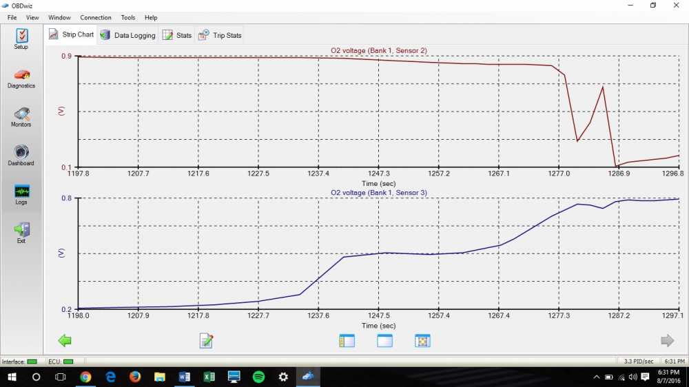

Back with the results....Finally haha. Sorry for the delay. Was in the process of packing things to go back to school and unpacking. Hate this time of year.
Anyway. I was able to hit WOT in first gear. I did it from a stop sign, turned and floored it but couldn't hold it as much as I can in 3rd or 4th; so the pull is short. Hopefully it is enough to see a trend. I also collected some data on the highway (when I usually get the MIL) at WOT in 5th gear. I took LTFT and STFT data vs. Throttle Pos. The graphs are attached. The equivalence ratio seems to decrease when WOT is hit. On the highway, It doesn't seem to dip too much at first but slowly starts to decrease.
However, Let me know what you think.
Thanks.

10 years 2 months ago #1383 by Mazda3GT
Replied by Mazda3GT on topic P0171 - 2008 Mazda 3
These are the other charts
10 years 1 month ago - 10 years 1 month ago #1619 by Tyler
Replied by Tyler on topic P0171 - 2008 Mazda 3
Back again, finally!
I think you can really see the issue in how the short term trims react to throttle position. Even some light throttle application results in big fuel trim changes. This *seems* like an air measurement issue to me.
My only problem with that is how we were seeing 100% Load in previous captures. By itself, that tends to suggest the MAF is measuring correctly. Every time I've seen a MAF problem, it's always resulted in a low Load calculation. This is why I have a hard time suggesting parts replacement, lol.
Like you noted in the opening post, fuel pressure is still on the table. Any luck finding a different test kit? Speaking of fuel, there's also ethanol fuel to consider. This page does a pretty good job of keeping the procedure simple. If we're on the right track with fuel quality, then this test will show FAR more than 10% ethanol.
