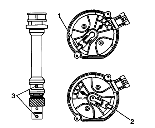

Dave here, I am having problems after replacing the intake manifold gaskets. I had a small water Ieak at the intake manifold and changed the intake gaskets and went to start it. The truck a 2001 Chevy S10 with a 4.3 auto.It cranks good and has a good charged up battery. I checked for spark, good, with a fuel P/T I got 55 psi. and it held for a good long time. I ohmed out the injectors and they all were within 2 ohms. I checked for injector pulse all good. My lights security light and dash lights all work and no check engine light or codes. I can smell fuel but no start. I have tried spraying starting fluid into the intake hose but still no start or want to start. Need help.

I'm wondering if distributer had to be removed.
I'm thinking the distributer could be stuck wrong or the wires misrouted.

9 years 2 months ago #11737 by carguy123
Im with Noah, I Did a 5.7l and was 1 tooth off and I played hell getting it started.... you can ck on scanner pid to see if is advanced/retarded there are very sensitive .
good luck!
9 years 2 months ago #11738 by gav09
Bring it up to TDC #1 and take the distributor cap off. Look at the base and see if the rotor lines up with the little 6 on the distributor. If it doesn't your distributor is stabbed wrong.
