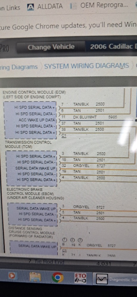

Replied by Noah on topic 2006 Cadillac dts no crank no start
If you are suspecting the TCM, you can bypass it by splicing the data wires.
Tan/black to tan/black and tan to tan.
It probably still won't start but if you regain communication with the rest of the modules then you found your problem.
Sorry for the picture quality.
