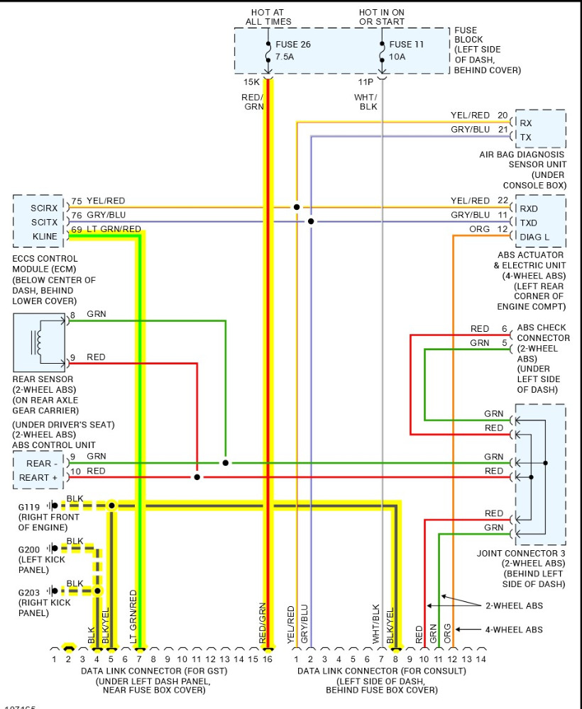

Yes there is now power on the 16 pin OBD port and the two grounds are there but no communication with any scanner. I'll attach a wiring diagram of this system in my next message, about 6 PM today. Thanks

1 year 9 months ago - 1 year 8 months ago #66027 by Marti
Here is the wiring diagram from automotive electricians portal

1 year 8 months ago #66131 by Monde
How about the K-Line on the 16 pins connector (OBD2)? If you have a breakout box, you could  connect the scanner on the obd2 port and see if you have activity on pin 7 at the box when you are attempting to communicate. Since the truck runs, most likely the resistors are fine. If you want to check them, ohm pin 6 and 14. 60 ohms is ideal.
1 year 8 months ago - 1 year 8 months ago #66132 by Chad
Any suggestion on getting communication on either the OBD2 or Nissan Consult connector for diagnostics? Do I look for resistance with all the power off? Which pins do I check ohms, and which of the 2 diagnostic ports...
There is not much to the communication with the ECM via the OBD2 DLC.
First, make sure that you have good battery voltage on Pin #16, and good grounds on Pins #4 and #5 of the DLC.
Next, as Monde suggested, check for voltage activity on Pin #7.
The K-line (pin #7) should have 12 volts when there is no network activity,  and toggle to ground with communication.
That's all there is to it. If you find you have nothing on Pin #7, you need to go to the ECM, Pin #69, and check there.

1 year 8 months ago #66230 by Marti
With key on engine off (KOEO) there is 7.7 volts on the K line (pin 7). It goes to about 9 volts with engine on. Pin 16 shows 12 v with KOEO and 14 volts with engine on. The two can lines 6 and 14 show no continuity with the ohm meter connected between these pins. What's the next test?

1 year 8 months ago #66238 by Chad
 A quiet, idle K-line should have 12 volts. If you are using a volt meter, and there is something that is trying to communicate, such as a "babbling node",  you could be reading the average of a square-wave.
Should I try to put an oscilloscope on pin 7 and try to communicate?
Yes. That will answer the question of whether you have low voltage on the K-line or, if there is something trying to communicate.
This vehicle does not use CAN. Pins 6 and 14 are not used.
