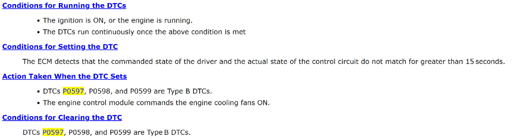

That P0597 code has been there for a while (at least 6 months). I figured the thermostat heater wasn't affecting drivability, so I put it off. The car did have a coolant leak that caused it to overheat last year sometime, but no issues with that in a long time.
The car had been sitting for 5 days after I reset the ECM, and today we drove it for about 15 minutes. There were no problems from the A/C during that time. I was watching the live data from the passenger seat, and everything looked good. I measured the thermostat heater resistance at around 400 kΩ, so it's definitely failed open. I'm going to go ahead and replace the thermostat to take care of that code, and hopefully it will take care of the A/C problem too. If the issue comes back before I replace the thermostat, I'll disconnect the heater and bridge the cable contacts with a test light to see if that makes the A/C work. Will update either way!

Just updating this in case anyone else has the same problem. I replaced the thermostat, and the A/C has been working great. I had found that the A/C would stop working after 4 engine start cycles, and it's been working for a lot more than that, over a week now. The P0597 code also cleared on its own. So there was definitely some connection between the thermostat heater fault and the A/C not working. Thanks for all the help!

Congrats on the fix! We always appreciate the follow up.
GM dropped the ball on that one, IMO.
Now isn't that interesting. Because I looked up GM service info for P0597 - it didn't say anything about taking the compressor away.I had found that the A/C would stop working after 4 engine start cycles, and it's been working for a lot more than that, over a week now.
