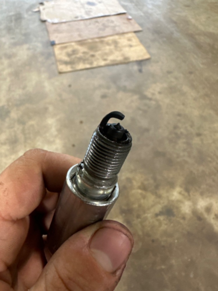

My truck started to misfire out of nowhere. Limped it to my fathers house so we can have a look. short term fuel trims on bank 1 were just fine, bank 2 side were awful at -30.5%. long term fuel trims on both sides were between 10-18% (cannot remember +\-). checked everything except for noid light testing. will attach notes on tests. everything on ignition side looks satisfactory. i had grey smoke that reeked of fuel coming from my bank 2 exhaust pipe. fuel injectors were checked for leakage but they did not leak. fuel pressure regulator also does not leak. compression was great. sparkplugs 2 4 and 6 had sooty residue, sparkplug 4 smelled of fuel. sparkplug 8 looked fine. bank 1 side plugs were satisfactory. distributor cap and rotor had no issues.
only problems dad and i found that COULD have been the issue was some oil around the base of distributor and some inside the intake manifold.
