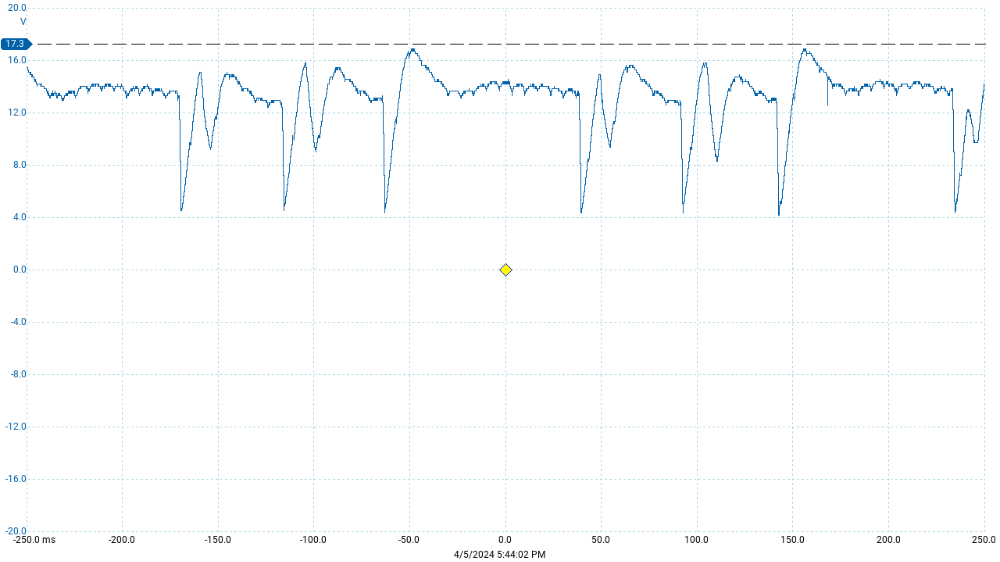

So li have a question maybe someone can help me working on a 2011 Mercedes GL550 and things are going a little wild i have no throttle response and maf codes and missfires on a couple cyl my throttle sig on scan data are opposite like they are supposed to be for about 2 sec then the go to the same number and my maf goes to 175 200 g/s and the throttle in the computer actual stays fixed at idle thien it will all snap back to the correct reading and then boom snap back..
for lack of time wasted reading useless information some of the ig coils and maf and injectors fun from the same 12v feed.. on said 12v feed wire im pretty sure that im getting secondary spark back feeding through i am wondering if the capacitor in the 12v feed wire that is marked radio interference suppression capacitor could be causing this issue or it might be more of a computer issue they have the computer mounted to the top of the engine and they are know for computer problems here is the scope photo of my 12v feed at the maf while plugged into maf

That capture almost looks like a bad alternator diode test.
It's not exactly clear to me what the symptoms are you are going after here, (over reporting MAF and something throttle position related?) but I'm curious to know if they go away with just the key on engine off, or with the alternator disconnected.

with the key on engine off you have a flat 12v signal once engine started it goes to that waveform.. you have no throttle responce maf problems and multiple miss fires..... and then once the engine is shut off after about 2 sec it goes back to a flat wave form again

i also un hooked the alternator and it didn't make any difference my signal still looks the same
