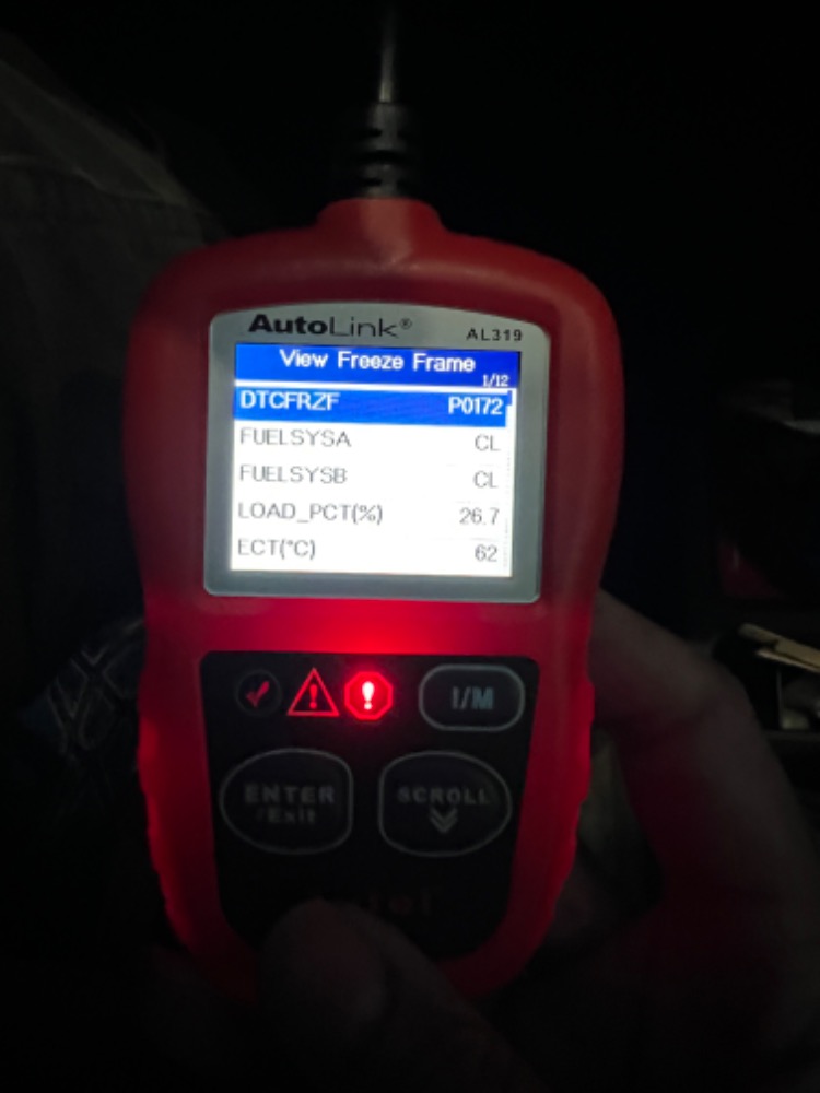

P0172 2000 Toyota Sienna was created by riqs67
Newbie with the questions. 244 000km on this Toyota
i have owned this Sienna for 11 trouble free years then came the P0172 :Initially no codes set but lost power up a hill like the transmission was done :After a restart drove ok then eventually became undriveable : Parts cannon started with a new MAF but no change : went to a mechanic and they told me it was an 02 sensor (not AF sensor so that may still be an issue )Bank one / that did not fix it as the code came back
they said it was an injector on bank 1 : I ordered 6 refurbished Denso’s and they changed the plugs , wires , fuel filter and PCV. This did not fix it and they gave up / I bought a scan tool to try and sort this out myself now
I pulled one of the plugs on bank 2 and it was dark like it was running rich : the exhaust smells rich have a known good MaF / cleaned the IAC and the throttle body / vacuum is around 18 on the gauge
i am about to test for the fuel pressure as it did not look like the mechanic did : the fuel pressure regulator is with the fuel pump in the tank and I believe this is a returnless system with the excess fuel staying in the tank ?
if the fuel gauge shows normal pressure, where else should I look?
Thanks , Rick (Vancouver BC

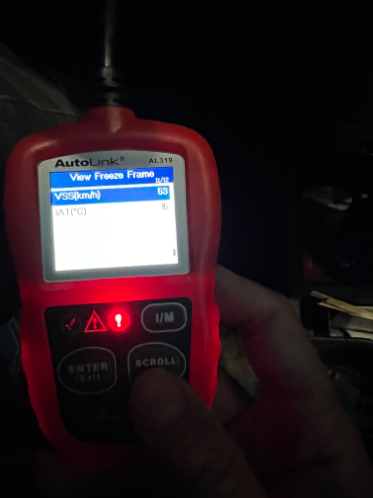

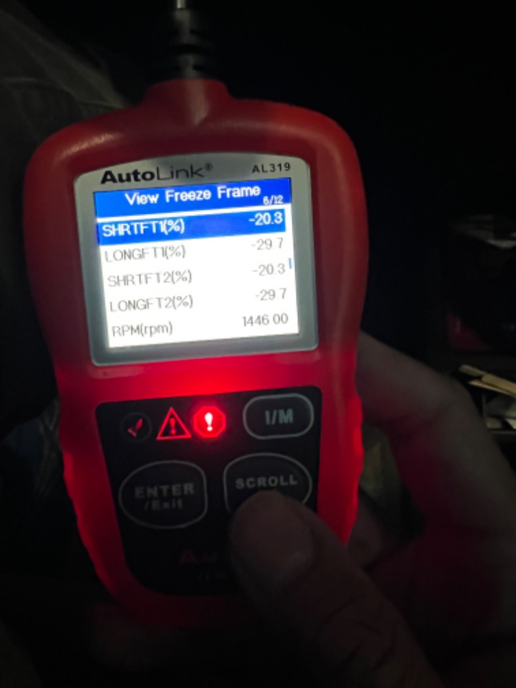

Holy negative fuel trims in that Freeze Frame.
Given how both banks are equally negative, I think it's safe to say there's something impacting both banks.

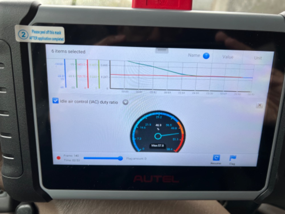

I know you replaced the MAF, but I'd still suggest checking its readings anyway. At hot idle with no loads on, we generally expect the MAF rate in g/s to equal engine displacement. In this case, 3.0 g/s.

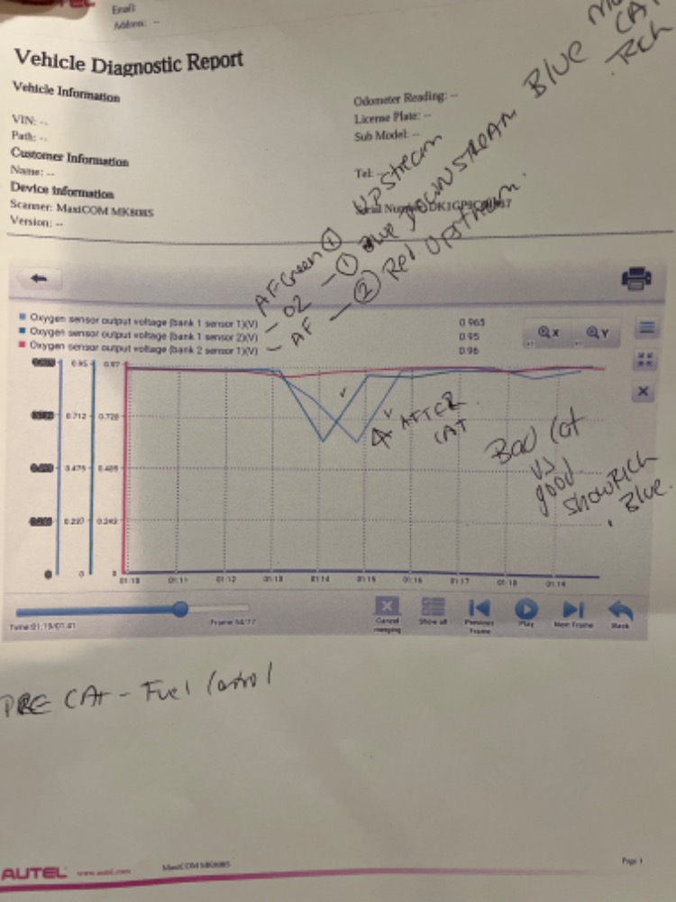

I'd also suggest watching the O2 signal and trims while the engine is warming up from a cold start. I see you've got a capture from an Autel, but again, I'd suggest doing your own oxygen sensor testing. With the engine at a hot idle, create a large vacuum leak and make sure all three O2 respond quickly. Add brake cleaner to the same vacuum leak and look again.

MAF is between 5-8 on startup then settles down to between 3 and 4
O2/AF sensors don’t seem to react to rich conditions or lean when I tried they stayed maxed out in the .95 .97 range
I wonder now if all the injectors I replaced are bad : I did not see the data when it first happend to know if both banks were rich or just one when they said to change an injector on bank 1
I pulled and cleaned the bank 2 a/f and it looked ok better than the spark plugs that are black :
The only way I get negative on the voltage /o2 sensor is right after I blip the throttle and the engine gets more air
Bank 2 sensor 1 still moves slow but in the same direction as the other 2
