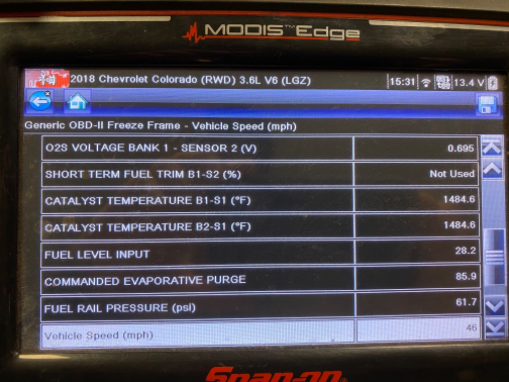

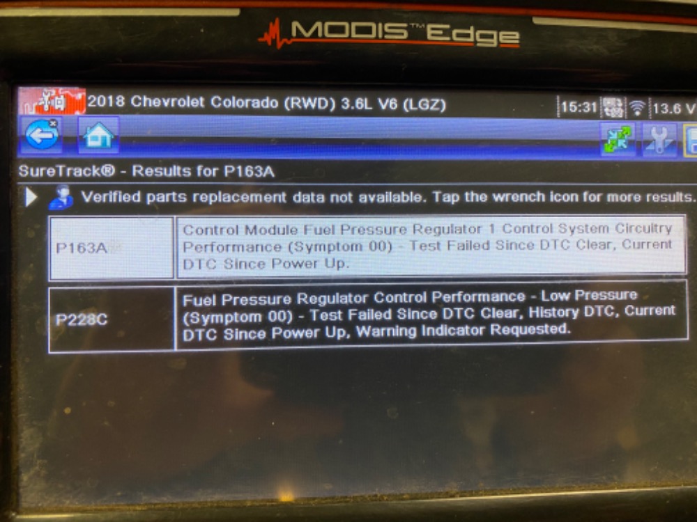

So I’ve got a doozy, 2018 colorado 3.6, we did a used engine swap and it has turned into a disaster. 23k on engine and used the original wiring harness from the original engine, the fuel rails, injectors and injector harness and high pressure sensor are all from the salvage engine. After the first test drive we got a p163a with no CEL, we have had these codes also but not consistently, p0090, p00c8 and p228c, those codes only occurred once at different times the p228c occurred by itself with no other codes and put me in reduced power, the p0090, p00c8 and p163a all occurred together and gave me reduced power at one point also but it seems the only codes that returns with consistency is the p163a but does not trigger a reduced power situation, the vin is-1GCGSCEN5J1118135, we’ve changed the high pressure fuel
pump with a GM unit, called identifix and went through the diagnostics and replace the ECM, no good, then identifix suggested I run a new circuit straight from the ecm to the high pressure fuel

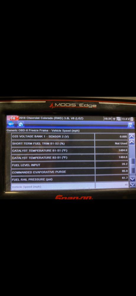

pump, I used new pins on the x3 ecm connector and new 2 pin connector at the hpfp regulator and after about 60 miles the code come back, occasionally I’ll get a p228c with reduced power and the p163a, I’ve watched fuel pressure while driving and low is always between 50 and 60 and high is always over 550psi, freeze frame showed rail pressure at 61 psi when the light flagged, but there was no drivability change. The p163a always returns and the p228c occasionally flags and puts me in reduced power. I’m truly at a loss now it is very strange. Help

I was thinking that also I just can’t seem to see the correlation to the p163a code, the code refers to regulator control circuitry, the only things on the circuit according to the diagram is the high pressure fuel pump regulator, wires and ecm, all of which are new, I ran 2 new control wires from ecm x3 connector straight to the regulator with a new 2 pin connector, I just don’t know what else the ecm is looking at in the diagnostic strategy for setting the code

I am a little bit, definitely not as much as I should be, how would you suggest I go about it? I did have a new development though, I removed my new circuit from the ECM to regulator and found that if I pound this truck and lay it in the floor I can get it to store. P0090 and go into reduced power, it’s still a circuit code but I watched desired and actual on a graph and it is off comparatively
