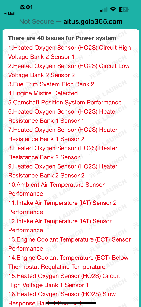

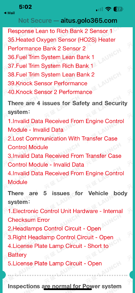

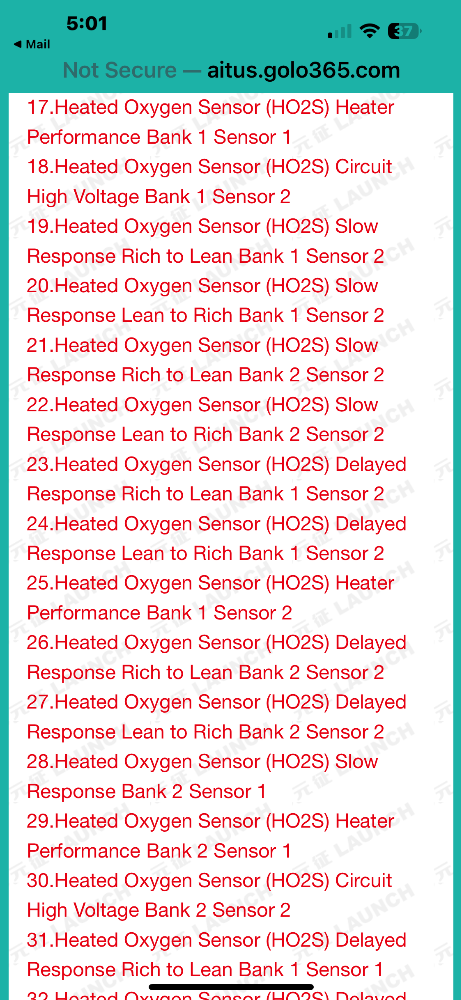

Swapped a 2018 5.3 into my 2015 suburban after my engine blew been running like crap and can’t figure out what’s causing this have changed the o2 and mass air flow sensors sometimes it will run fine but then it will return to running like crap and check engine light

5:01今E7• MailNot Secure — aitus.golo365.comThere are 40 issues for Power system:1.Heated Oxygen Sensor (HO2S) Circuit HighVoltage Bank 2 Sensor 12.Heated Oxygen Sensor (HO2S) Circuit LowVoltage Bank 2 Sensor 2

5:02今E7• MailNot Secure — aitus.golo365.comResponse Lean to Rich Bank 2 Sensor 135.Heated Oxygen Sensor (HOS) HeaterPerformance Bank 2 Sensor 2
- Fuel Trim System Rich Bank 2
- Engine Misfire Detected

5:01今E7• MailNot Secure — aitus.golo365.com17.Heated Oxygen Sensor (HO2S) HeaterPerformance Bank 1 Sensor 118.Heated Oxygen Sensor (HO2S) CircuitHigh Voltage Bank 1 Sensor 2
- Heated Oxygen Sensor (HO2S) Slow Response Rich to Lean Bank 1 Sensor 2
- Heated Oxygen Sensor (HO2S) Slow Response Lean to Rich Bank 1 Sensor 2
- Heated Oxygen Sensor (HOS) Slow Response Rich to Lean Bank 2 Sensor 2
- Heated Oxygen Sensor (HO2S) Slow Response Lean to Rich Bank 2 Sensor 2
- Heated Oxygen Sensor (HO2S) Delayed Response Rich to Lean Bank 1 Sensor 2
- Heated Oxygen Sensor (HO2S) Delayed Response Lean to Rich Bank 1 Sensor 2
- Heated Oxygen Sensor (HO2S) Heater
- Heated Oxygen Sensor (HOS) Delayed Response Rich to Lean Bank 2 Sensor 2
- Heated Oxygen Sensor (HO2S) Delayed Response Lean to Rich Bank 2 Sensor 2
- Fuel Trim System Lean Bank 1
- Fuel Trim System Rich Bank 1
- Fuel Trim System Lean Bank 2
- Knock Sensor Performance
- Knock Sensor 2 Performance
- Headlamps Control Circuit - Open
- Right Headlamp Control Circuit - Open
- License Plate Lamp Circuit - Short to Battery
- License Plate Lamp Circuit - Open

I swapped the motor because head gasket blew on my 2015 at 245000 miles so I found a wrecked 2018 and took the motor tranny and exhaust cats and all it started off as down stream 02 sensor low voltage so swapped that to a new oem one went ahead and put a new mass air flow sensor

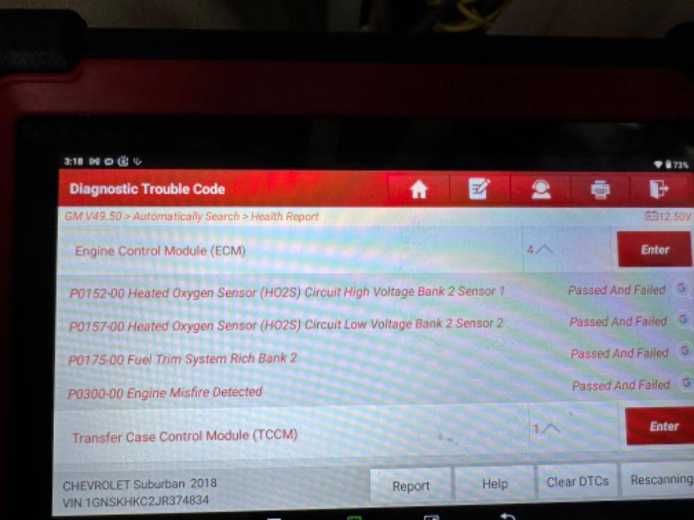

2 years 8 months ago #63961
by 907arlen
Replied by 907arlen on topic 2015 Chevy suburban l83 5.3 swapped the engine from a 2018 5.3 runs like crap
I cleared the codes checked for pinched wires nothing stood out now I’m getting a p0157
P0175
P0300
P0175
P0300
- Hardtopdr2
- Posts: 853
- Thank you received: 150
2 years 8 months ago #63963
by Hardtopdr2
Replied by Hardtopdr2 on topic 2015 Chevy suburban l83 5.3 swapped the engine from a 2018 5.3 runs like crap
ok now unplug maf and see if fuel trims improve. if not then swap both o2 sensors from bank two to bank one. see if problem follows. if not your injectors might have an issue like sticking open/ debris.

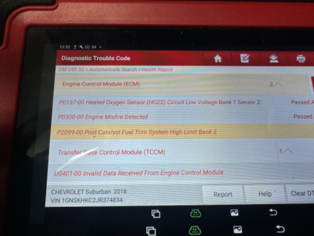

2 years 8 months ago - 2 years 8 months ago #64186
by 907arlen
So I switched them over I wire brushed the soot of the outside of the o2 sensors and the truck ran flawless for about 5 hours then this am check engine light came back and misfire and low voltage bank 1 01 b1 o2 so seems the problem did follow it then it threw bank2 o2

2 years 8 months ago #64190
by Hardtopdr2
what were the code numbers? and which o2 had the problem follow up stream or down stream? and what code showed up for bank 2?

ok the downstream o2 that you swapped from bank two sensor two to bank 1 sensor 2 position looks to be part of the problem i would replace that 02 with a new one.
as for bank 2 looks like you will need to see misfire data (current and history data) and see which cylinders are misfiring and address that issue before resuming the p2099 -00 code problem for bank two.
