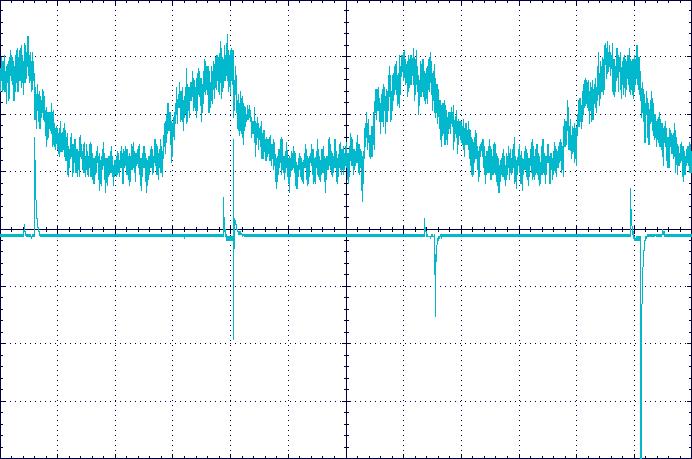

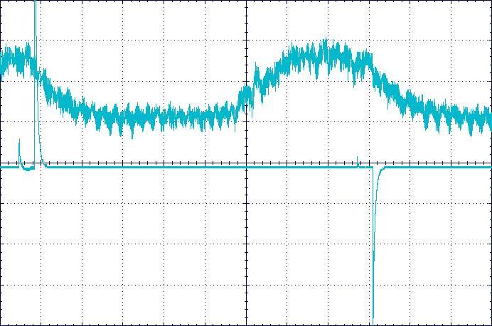

I'm working on fixing a 2007 Chevrolet Aveo for a relative.
The idle is rough and manifold vacuum is only 14" hg. The timing belt was changed a while ago and the driver thinks that it started after the timing belt change. No misfire codes at this point. I liked the example in PD's book and videos of comparing peak compression to cylinder spark event to determine if the timing is off and did that test. I have a couple of waveform .bmps I would like opinions on. In each, the top trace is a current probe around the battery cable during cranking and the second trace is a capacitive ignition probe around the cylinder 1 plug wire.

Hey RH6400!
At first glance, it looks to me like spark timing is OK. A little bit retarded of TDC, sure, but that may be the default timing strategy on this engine. I'm eager to hear what others think of your captures.
What actually caught my eye was the relative compression waveform itself. The large U-shaped valleys in between the compression humps looks unusual... Kinda reminds me of other captures I've seen on engines with jumped timing. Not saying that's your issue, just thinking out loud. ;-)
If you can get to the cam and crank sensors, we can try a cam/crank waveform compared to a known good, and see if there's anything obviously out of alignment.

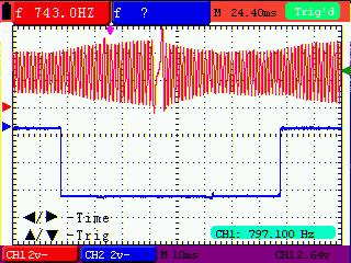

Hi Tyler,
Attached are captures of the crank and cam sensors.

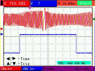

8 years 10 months ago #10927 by gav09
Replied by gav09 on topic Aveo 2007 Rough Idle and Low Vacuum
here is a known good.

Hi gav09,
Thank you for the waveform. Is it from an Aveo 2005-2007? Also, it appears to me that mine is off a little. Do you have any thoughts on it?

8 years 10 months ago #10944 by Tyler
Replied by Tyler on topic Aveo 2007 Rough Idle and Low Vacuum
The cam/crank relationship seems OK from what I can see. It's tough to get an exact tooth count, but I saw 26 teeth from the sync notch to the cam transition. As this is a DOHC engine, it's still possible that the other cam is out of time, but you'd have to pull the top timing cover to verify. :-(
