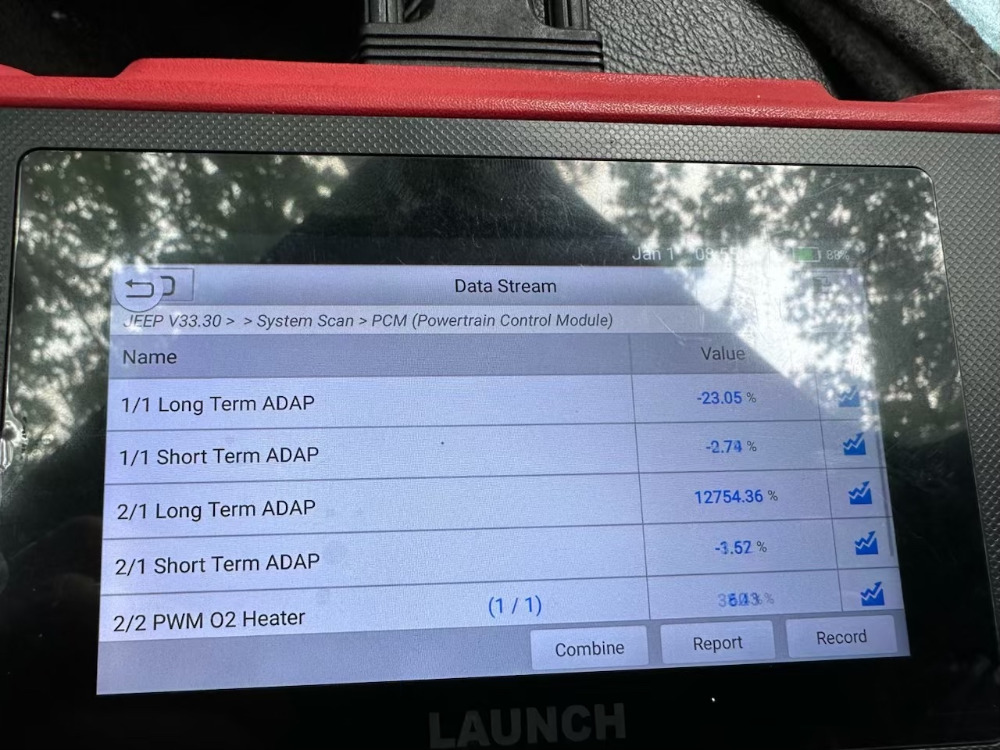

Gday All! 2006 Jeep Wrangler...was wrecked and had many diagnostic codes when I got her 3 years ago. This is the last gremlin I just can't seem to get resolved. Triggers p0175 and p0172. Propane test has never shown me a vaccuum leak...that I can find at least

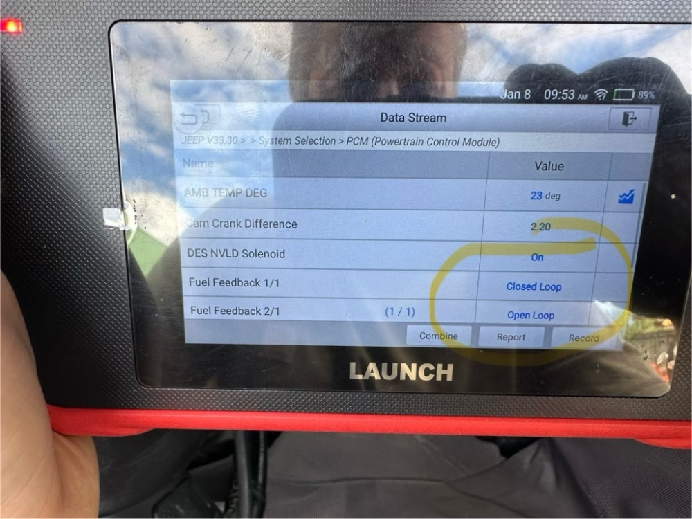

Today I put in new Mopar fuel injectors...and upon first start I got some less crazy readings and closed loop on both banks...then randomly back to the crazy non-moving 12,776.99% 2/1 long term and open loop 2/1.
Vehicle runs & drives, but you can tell at idle its not as smooth as it should be. And she drinks fuel way faster than this 4.0 should (I've had a few)

That's kinda awesome! I'm gonna chalk those astronomical fuel trims up to a scan tool/Launch problem. In my experience, the only aftermarket scan tool that seems to be able to talk to this generation of Jeep correctly is Snap-On. Launch, Autel and TopDon really struggle, and you end up with readings like this.
First thing I'd say to check would be to check the fuel trim values in Global OBD instead, especially when you're seeing the 12,000 reading. In this context, I'd trust the OBD readings over the OEM data.

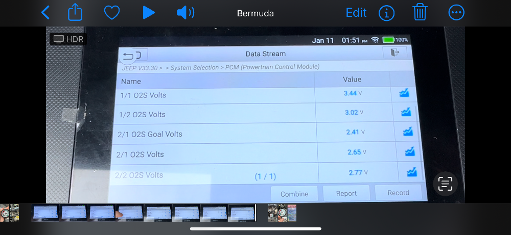

6) O2 Goal 1/1 + 2/1 PIDs - I'll scan this tomorrow in daylight and post the results.
7) O2 sensor voltages...again I'll run her and post a video with scanner data. I've checked that a few times and seems to be operating correctly....*to my limited knowledge*.

O2 voltage readings attached…
