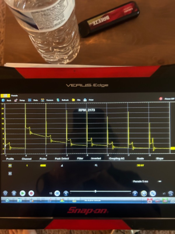

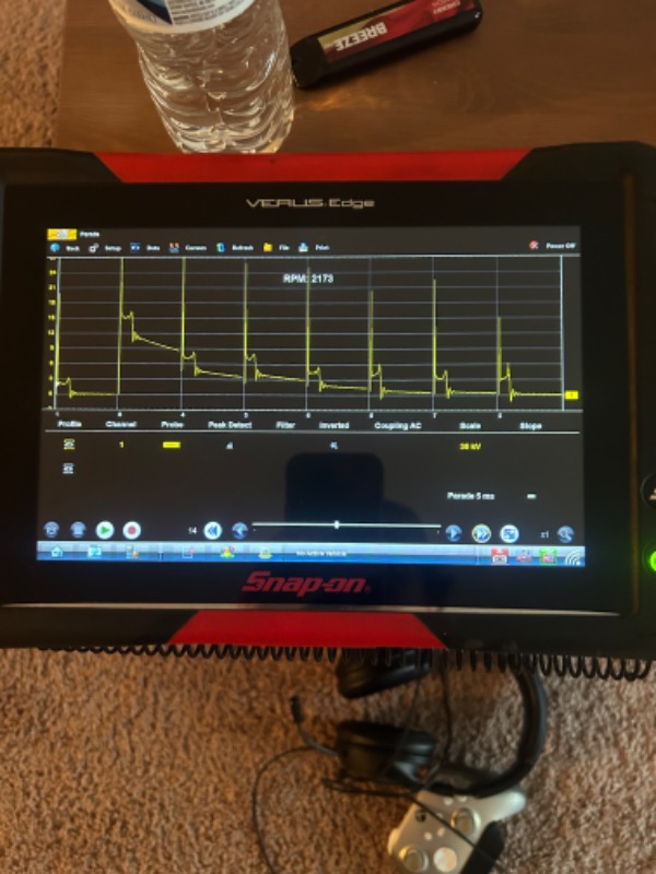

I picked up my versus and copy of danners book and trying to get into it with my own vehicle that has a rough idle(shake that looks kind of like a misfire) it runs great at any other speed and I can’t really say that it has trouble taking off from a stop either. I have a picture of the waveform and when snapping the throttle it seams cylinder 8 jumps way up on the kv scale above any other cylinder. I attached a picture and need some help figuring out what all this means.

Looks like a plug wire issue with a lot of resistance.

That’s what I was leaning towards but it also has a new wire newish plug new cap and rotor.

Probably a cheap brand replacement wire. Only way to know for sure is put a plug wire on
