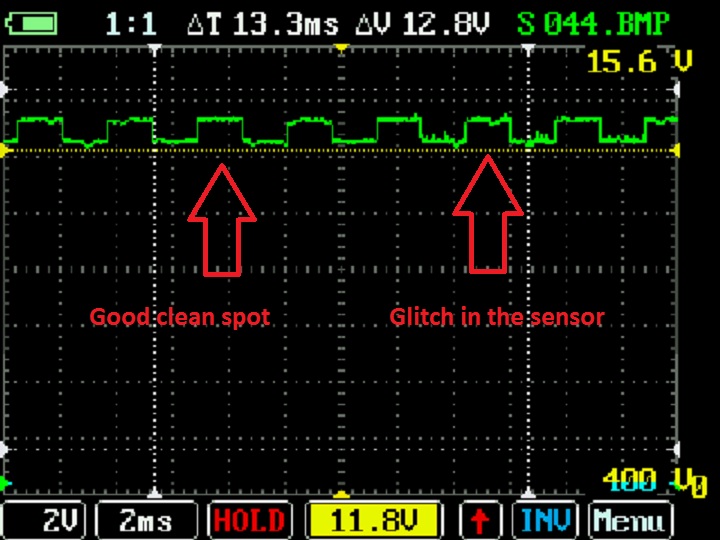

8 years 10 months ago #10759 by gav09
Like everyone said you will lose the 12v if the EBCM detects a sensor or wiring fault. Here is a waveform of a 2010 pickup that would randomly set a wheel speed sensor code. The bad spot doesn't look like much but after speed sensor replacement the waveform was very clear cut like the good spot in the waveform.
The following user(s) said Thank You: Tyler, josue1180
