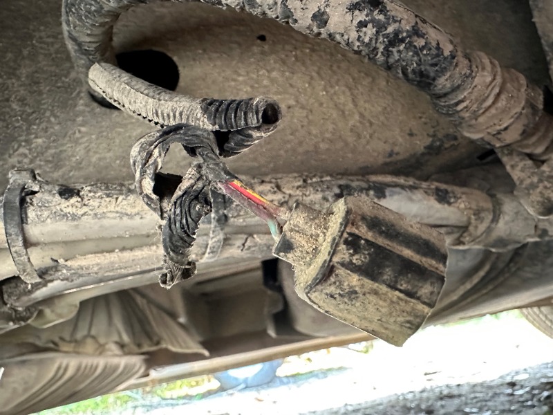

2 years 11 months ago - 2 years 11 months ago #63106
by WoodsTruck
Replied by WoodsTruck on topic P0131 P0132 P0135 (and fuel backup when filling)- 2003 Ford Windstar
Update: I did a bit more investigating today and wanted to share my findings so far. I have not tried filling up at the gas station yet with the hoses removed but will try tomorrow and report back.
-There are 4 hoses total that I could locate near the charcoal canister, two towards the front of the van and two towards the rear. The two towards the front both conenct to the vent solenoid. One towards the rear (with a push-to-release connector) looks like it connects directly to the charcoal canister, and the other connects to the smaller rectangular filter before then continuing into the charcoal canister.
-I did some loaded circuit voltage tests at the vent solenoid with the connector plugged in and KOEO. There is a purple/white wire and a red/yellow wire. I used a test light as well as a multimeter. I was getting battery voltage on both wires, but one of the wires (i believe it was the purple/white wire) made the test light glow much brighter.
-I also removed the vent solenoid connector and did a resistance test across the two pins of the vent solenoid and got a reading of ~60 ohms.
-With the vent solenoid removed from the vehicle, I applied power and ground from a spare charged 12v battery I have laying around. I could not gear any type of sound or feel any type of movement when doing this. I also did an in-line amperage measurement with my multimeter while applying power and ground to the solenoid, and got a reading of around 3-3.5 Amps. This seems very high to me, but I don't know for sure. My guess with what I have tested so far is that the vent solenoid is shorted out internally. It also seems like it initially got stuck due to charcoal pellets getting stuck in the solenoid. A bunch fell out when i removed it and i can hear more rattling around in there.
-I also noticed some damage to the wires just before the vent solenoid connector (picture attached). I actually thought the wire was green instead of purple/white until I pulled some tape off the wiring harness to do my testing. I am wondering if this could be part of the problem, or maybe a symptom of the solenoid shorting out?
My main questions at this point are:
-Should I hear or feel the vent solenoid actuating with power applied? My thoughts are my testing so far show it is bad (or at least clogged and unable to move).
-Does anyone have a diagram of the evap system for this vehicle so i can wrap my head around which hoses go to where?
