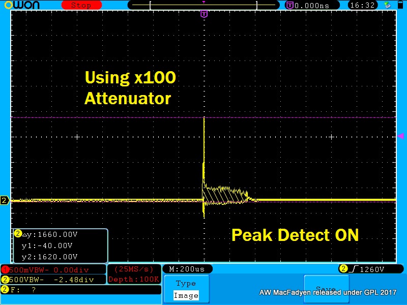

9 years 4 months ago - 9 years 4 months ago #10668
Replied by Andy.MacFadyen on topic Hi secondary voltage
I did a test with a spark gap tester just see what voltage a coil primary can kit out and still produce a strong spark on the secondary I was a bit surprised this is pushing the spark gap to the max with peak detect turned on. 1.6kV
Last edit: 9 years 4 months ago by Andy.MacFadyen.
The following user(s) said Thank You: johnphufnagel

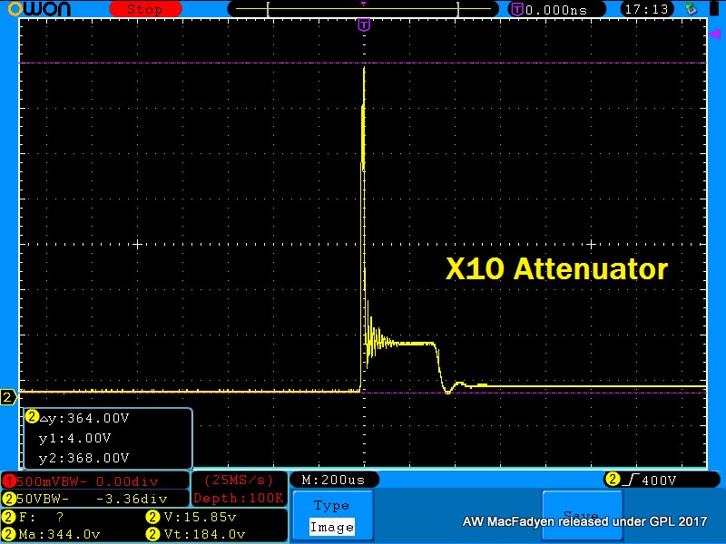

9 years 4 months ago #10671
This is a more sensible test run the air gap wasn't that huge using the x10 attenuator as I broke the x100 and the scope hasn't an x20 scale.
Cursor Reading 360v but it fired the trigger set to 400v
