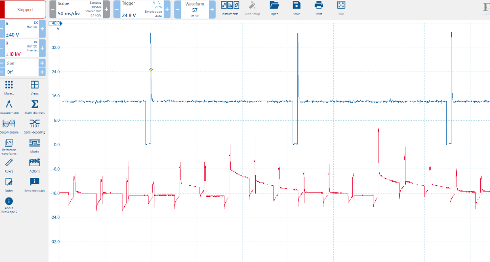

2 years 3 months ago #63699 by 04300EXC
Replied by 04300EXC on topic 1995 Jeep 4.0 - lopes at idle - rich condition
OK guys - I have some more info on this problem - I scoped the No 1 injector and a parade of secondary ignition - the ignition patterns do not look right... please comment - next I scoped the No 1 injector and the No 1 plug wire (secondary ign).... they do not align with each other. It looks like the No1 plug is firing on No 6 ????? Next I moved the scope pickup from No1 plug to No6 plug.... this looks aligned with No1 injector,,,,,?????? so is this engine either firing or injecting fuel 180 degree out of phase???? How does it even run? It starts right up, revs pretty clean but lopes at idle when in closed loop. Please comment and help.... I am at a loss
2 years 3 months ago #63700 by Chad
Port injection engines do not fire the injectors at the same time as the spark plugs fire. The Injectors are, usually, fired during the intake stroke.
Direct injection engines fire injector during the compression stroke.

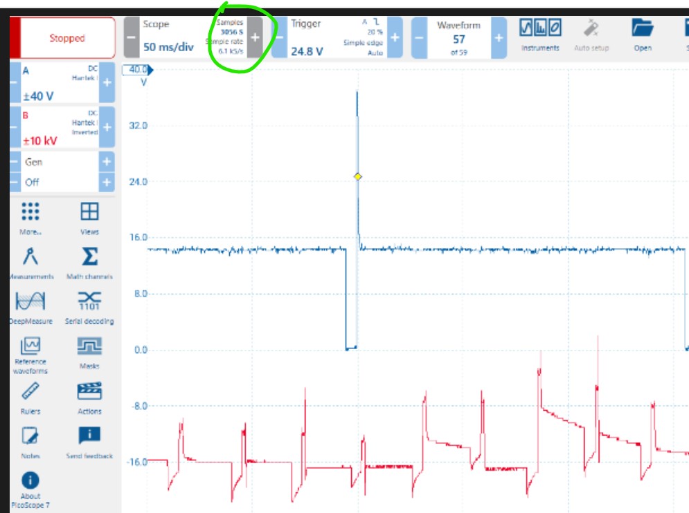

2 years 3 months ago #63701 by 04300EXC
2 years 3 months ago #63703 by Chad
Your sample rate is too low. Set it to, at least, 1MS/s.
