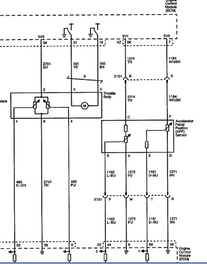

In looking at my Mitchell wiring diagram and several diagrams I found online it appears the TAC module does not get the 5 volt reference from the ECM and that it makes it on its own but I'm not positive on that. I can upload my wiring diagrams if you need to see them I just don't want to condemn this module if there is any chance it is not bad.

It occurs almost every time it is driven now. It used to be very intermittent. I did see a TSB for this showing moisture in a connector and I did find moisture in the connector and dried it out but I'm not really sure how to prevent this from happening again. Should I use dialectic grease on the female side of the connector?
The diagram I have doesn't show any connectors between the TAC module and the pedal but I am sure there are multiple that could have issues. Does anyone have a factory diagram they could upload showing the connections so I can check them?

Your parents are gonna be thrilled when they hear you (hopefully) fixed it with no parts changing. Which connector did you find moisture in, for our reference?
It's a little late now, but here's the GM diagram for this same system. I love Mitchell diagrams, but they do leave crucial details out...
Looks like X101 is the suspect connector?
