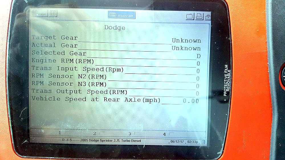

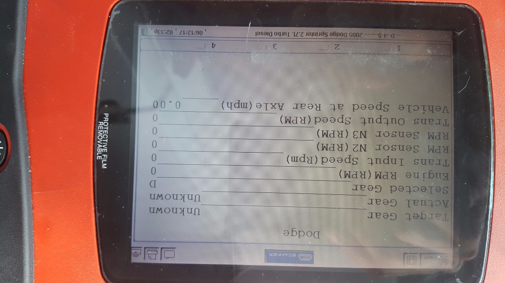

dodge sprinter
Showing unknown target gear selection. While driving and while vehicle is off.
Symptoms limited to 50mph high rpm

Engine RPM not showing either --- no coms.

The rpm works when driving on the road. This pic was when the vehicle is off with key on.

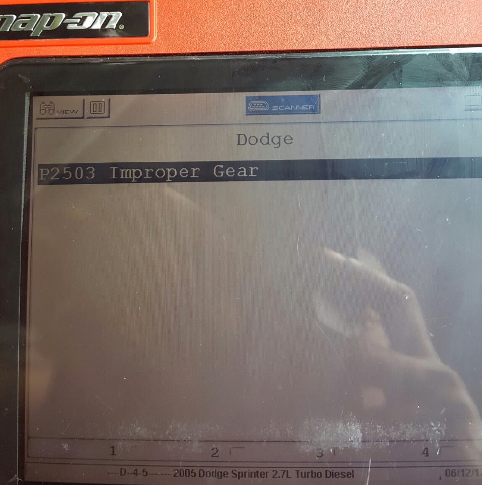

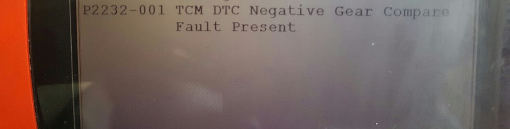

Code p2232 and p2503

While driving rpm moves correctly with dash reading. Target gear states unknown while driving doesn't change. Before it changed from 1 to 2 while taking off but now stuck at unknown.

P2503 and p2232
the scanner shows brake light pressed and released so I guess it's working

The code doesn't say alternator. Not sure why. There is no abs fault.
9 years 4 months ago #10361 by Ben
Replied by Ben on topic Re:Unknown gear selection
Oh huh that's nothing like what generic said those codes were! Guess I should have looked them up for the sprinter specific ... in that case if there's no and codes verify that all the sensors are reading while moving between 1 and 20 mph and none are dropping out if sensors check out then drop then you'll have to drop the transmission pan and inspect the valve body
