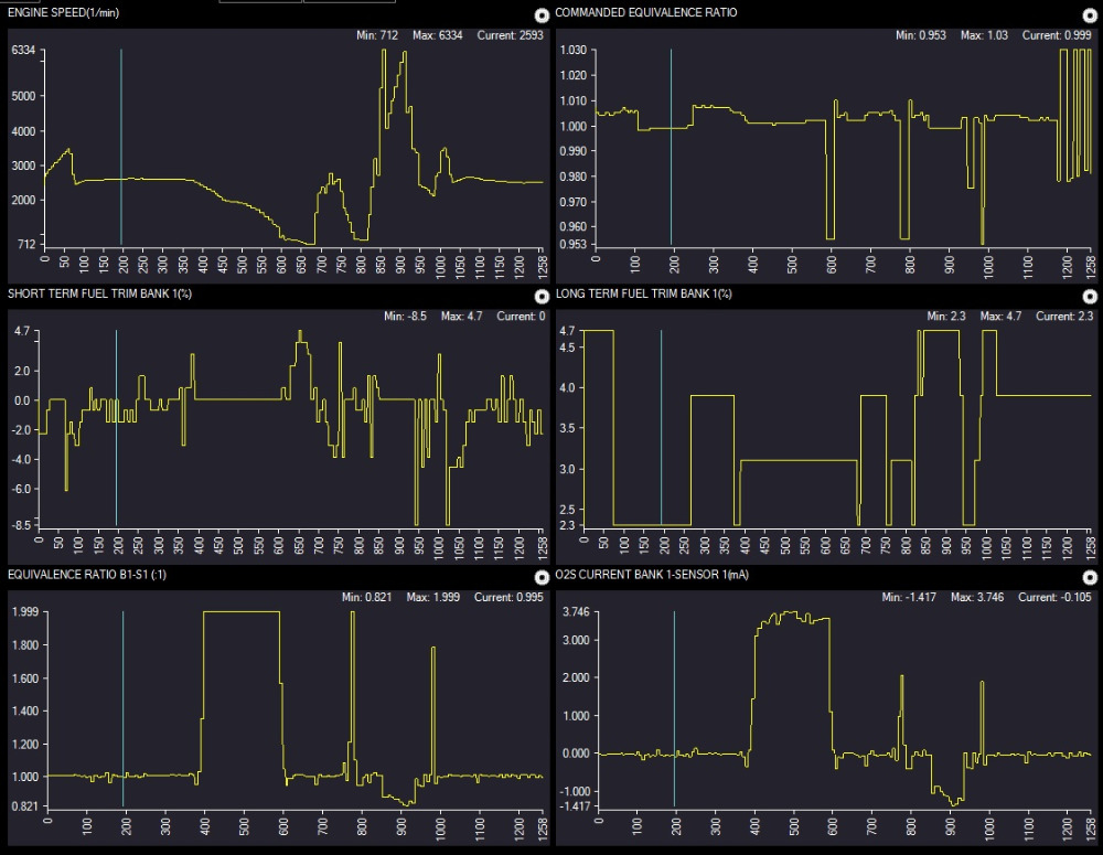

Hey JesusMercado! For our info, P2177 is defined as "System Too Lean Off Idle Bank 1" and P2187 is "System Too Lean at Idle B1", correct? That's what Google tells me, anyway, just making sure. ;-)
My first thought is that the upstream air/fuel ratio sensor has failed, and is falsely reporting a lean condition. When driving, does the engine feel like it's low on power? If not, that would suggest the lean condition IS false, and that the PCM is actually overfueling the engine. If it is low on power, then the lean condition probably does exist.

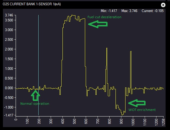

If you have access to Global OBD scan data, then it'll be very easy to track down a lying air/fuel ratio sensor by comparing the upstream sensor against the downstream. At idle, look at the Bank 1 Sensor 1 O2 Current in mA and the Bank 1 Sensor 2 O2 voltage. For reference, the upstream sensor will show positive current if the exhaust is lean, and negative current if it's rich. The downstream sensor works like a conventional O2, with low voltage representing lean, and high representing rich. Here's an example of what a working upstream sensor looks like, off an '08 Mazda 6.
If you see the upstream sensor showing lean, but the downstream sensor showing rich, then it's likely that the upstream sensor is lying. ;-) If they BOTH show lean, then it's probably telling the truth, and we can go further into a fuel delivery problem.

Thanks for getting back to me with those readings! Kinda weird that the upstream air/fuel ratio sensor always reads about -.2 mA... Did this reading fluctuate during your drive? The negative current indicates rich, which doesn't account for your lean trims, I just want to know the sensor is capable of reacting to changing fuel mixtures. ;-) What were the short term trims doing while driving? Staying high as before?
I think we can clear the air/fuel ratio sensor for now and go on to other possible issues. Any possibility that E85 fuel got pumped into the tank? That'd absolutely cause a lean condition. ;-) If you're confident there are no air leaks, and the fuel pressure is in spec, then I'd suggest revisiting the MAF. I see that you cleaned it already, but it could still be skewed anyway. :-(
We can do a quick test of the MAF by watching Calculated Engine Load during a WOT run through first gear and into second. You'll want to have the data list narrowed down to Engine Speed, Airflow Rate, Calculated Engine Load, Absolute Engine Load and the upstream air/fuel sensor current in mA. We want the Calculated Load to go over 90% and the air/fuel sensor current to go negative during the run. Low Load and positive sensor current would point towards a misreporting MAF sensor.
