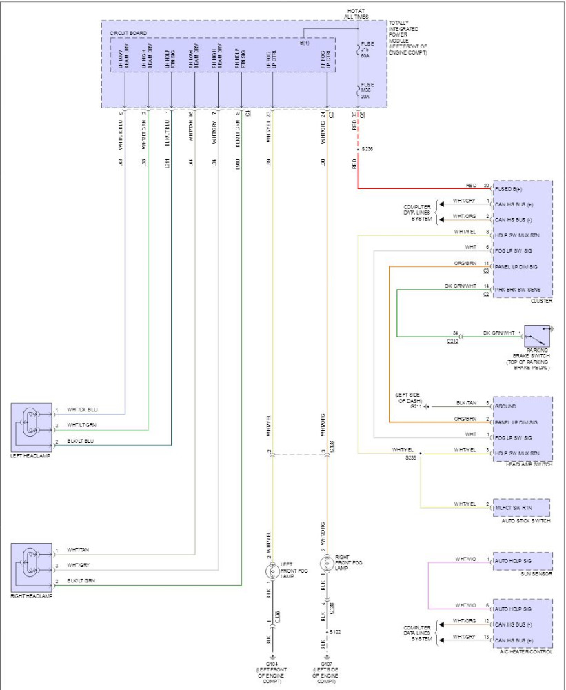

2011 dodge ram 2500 6.7l.
I have no left headlight low/high beam. Right side is fine. Wondering if anyone has a complete wiring diagram, or suggestions?

Here is 2010.

have you tried swapping bulbs from left to right?? easy and free. also is there a white/light green black and light blue. and white/dk blue wires at the headlamp?

Found the problem main harness to the headlight bucket had come undone. Locking clip has broken, zipped tied together.
