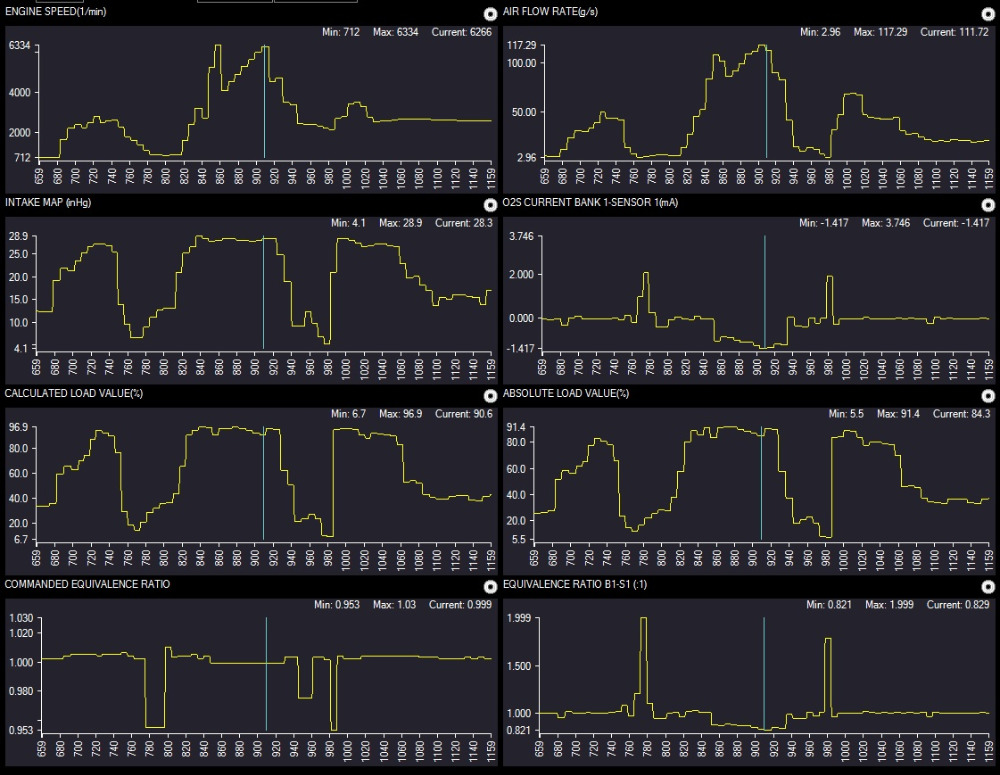

I agree with Andy's suggestions about a fuel delivery problem or possible plugged cat. Some scan data during a WOT run could definitely help point us in the right direction. We'd be interested in watching that upstream A/F sensor, the downstream O2, MAF, MAP, calculated load, absolute load, engine speed, commanded equivalence ratio and equivalence ratio. As an example, here's an shot of some data I took off an '08 Mazda 6 with a 2.3L:
With those PIDs, we'll be able to tell if the engine is getting enough fuel under load, as well as check for a volumetric efficiency issue, an intake restriction, AND confirm the rationality of the downstream O2.
