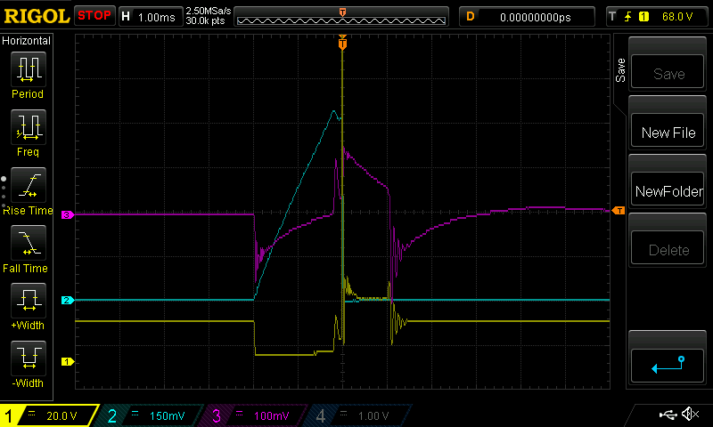

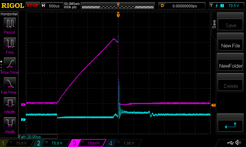

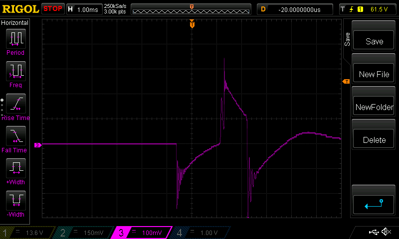

Hi,
I have a 1996 Jaguar XJ6 3,2 inline six with COP ignition. I bought two new coils (two because I wanted one in spare and I got a good price) because the rubber insulator of the old one was partly damaged (only complete coils was available). On the new coil I checked the secondary ignition with a COP probe and an oscilloscope and saw a rather strange waveform. I swapped a coil from another cylinder for comparison and this waveform looked good compared to the other cylinders and known good waveforms on the internet. Does anyone know what could be wrong with the new coil by looking at the waveform? I can also mention that the waveform of the new coils looks more like the old good ones if they are not inverted. The waveform on the old coils are inverted on the scope. I have also attached a waveform from one of the old coils that I think looks good (the burn time was an average of near 1ms but on the picture it is a little less), measured in the same cylinder as the new coil.

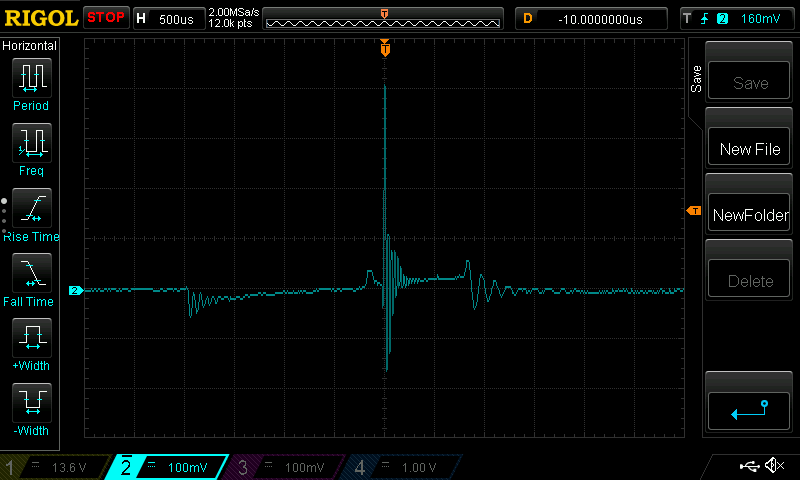

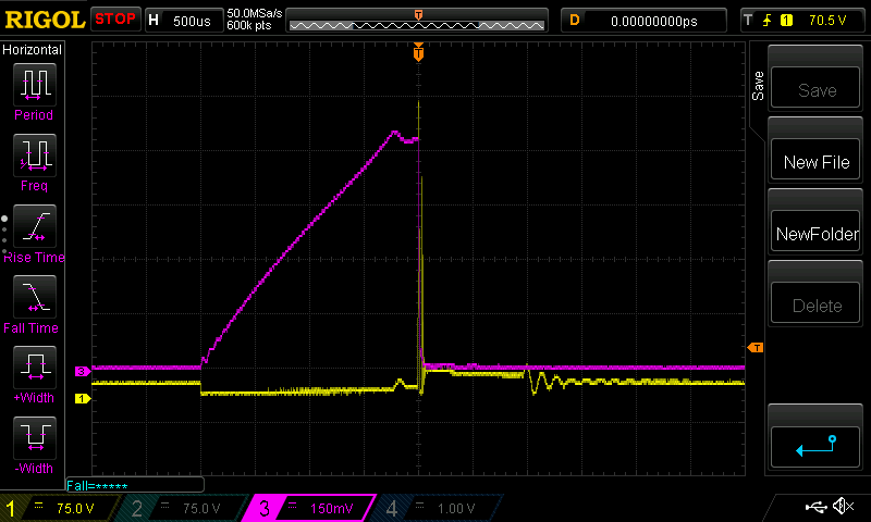

I have now performed both current and voltage measurements on the primary side. On the oscillograms the coil in cylinder no.3 is the new one and in cylinder no.2 is an old which seems to be ok. I notice that there are fewer oscillations at the end of the waveform on the new and also that the waveform are different at the end of the spike. Since I wanted to capture the short spike I used a high samplerate and therfore the traces looks a bit thick. Any comments to the new waveforms? In my experience the COP probe gives quite good readings and I think getting repetitive results is not very dependent of the position, but I have experience with this car only since I am now to car-diagnosing with oscilloscope. I have a DIS probe so I will keep this in mind, thanks for the tip. I also measured the primary resistance of the coils with a DMM and got 0,9 Ohm on the old one and 0,8 Ohm on the new coil which probably is ok.
