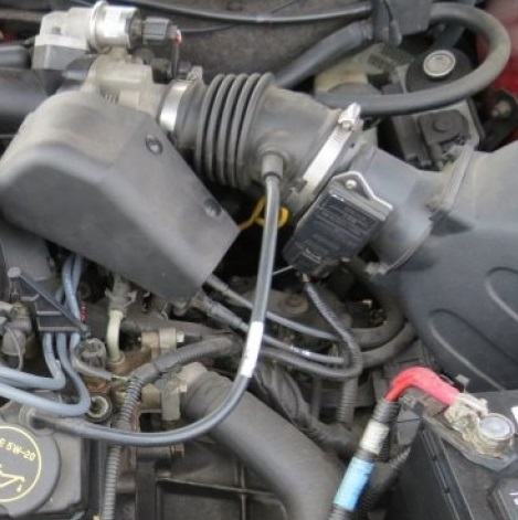

Thanks again Tyler! Actually I saw a link in the video's description for testing a MAF on a Ford. Of course he has his diagnostic tool as usual. But he also unplugs the sensor and the engine runs a bit better. If I were going to do that, it'd mean having to wait till all of the high octane fuel was burned and put 87 back in and see IF there was any improvement with pinging. Of course he also mentions that some vehicles will run as bad/worse by unplugging it. I was wondering about the knock sensor though. IF its supposed to retard timing when it detects pinging by frequency, then why wouldn't it stop the pinging?! As the only way for me to have reduced pinging is to either reduce engine load by letting off the accelerator and/or reduce the gear to bring higher revs with lighter throttle... Either way if I were to depress the accelerator more, increasing load, it'd of course ping worse...
I will have to look at the MAF sensor to see if its dirty. I was a bit puzzled by how dirty one of the MAF sensors he examined, was. My understanding is, IF the sensor is just after the air filter but before any PCV etc, then how would it get so dirty unless drivers neglect checking/changing the air filter etc.. As the air filter shouldn't allow such contaminants into the air stream.

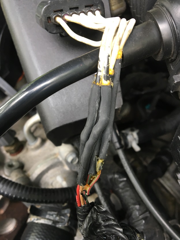

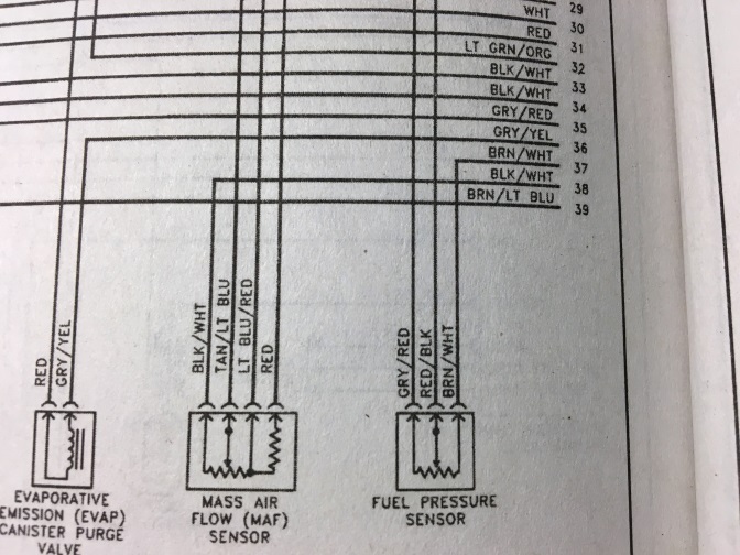

I did find something else kind of interesting at the start. As I began reading, it recommended I check the schematics. I'm not quite sure I understand these as the sensor/cnctr has 6 conductors. However, when looking at the schematic in the book, there are only 4 conductors... Finally, I noticed all of the conductors were the same color on the cnctr, so what I thought was true, someone spliced in another cnctr. So I had peel back to find the conductor colors. The odd thing is, the colors don't match up 100% w/ what is in the schematic... I wish I had a factory manual... I'll attach photos.
Last edit: 9 years 5 months ago by Costar. Reason: Fixed attachments

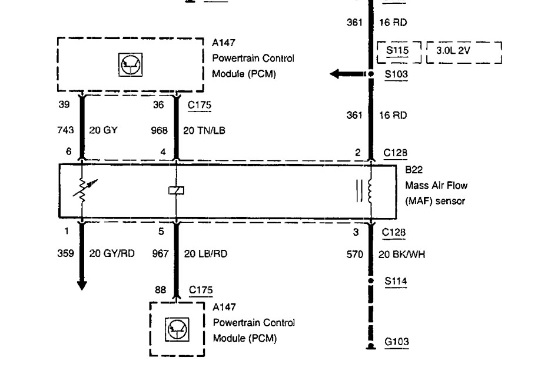

Thanks for the photos! Looks like someone did a decent job of sealing up those connections. Do your wire colors agree with the diagram I posted? Wondering if your book has a misprint. :unsure:

Thanks! I didn't even know that BBB Industries site existed. Yes the BBB diagram matches the car cnctr colors.
This book has conductors 1 & 6 by color code BUT it does not show them going to the MAF. I'm wondering something.. I just happened to look up wiring diagrams for 1996 on the BBB site. My suspicion is confirmed... These Chilton manuals, basically Haynes now, cover more than one year of vehicles and don't always make that clear for each page. In this case the wiring diagram is for at least '96+ Taurus which has a 4-conductor MAF and a separate dual conductor IAT sensor. And like in this manual, the BBB diagram shows the separate IAT and it just so happens, it contains the missing conductors, gray and gray/red... -_-
So apparently during these different years they went from a separate IAT and MAF to an IAT integrated in the MAF...
These electrical symbols I'm not so sure of in the BBB diagram. I've looked them up now but after looking over this '96 trace across 3 pages, I do see two "RTN" which I assume means "Return?".. There is a "SIG RTN" -coming from the IAT and a "MAF RTN".
These are apparently on opposite sides of the PCM. I'm not sure if the book is or I am, confused... Testing the "MAF signal wire" it gives the values mentioned earlier but then it said IF its suspected the MAF is bad, stop engine, disconnect MAF harness and probe "MAF signal terminal" (same thing as mentioned earlier just the terminal on the sensor instead of the wire on the cnctr) to see if the reading is "infinite" for the "hot element" -the resistor. But the resistor then is the IAT component which is gray and gray/red conductors....
Yep, you're right on about the signal return. That's manufacturer-ese for sensor ground. Why not just call it 'ground'? 'Cause Ford. The symbols are a bit unique - the rightmost symbol, between pins 2 and 3, is for the MAF sensor and the hot wire. The middle one is the MAF sensor signal itself, and the left is the IAT (as you probably figured).
Hmmmmmm, not sure what they're talking about on that one. :unsure: Maybe they want you measuring resistance across pins 2 and 3? Kinda a confusing test! :lol: Would you mind taking a picture of that page, just for my curiosity?
