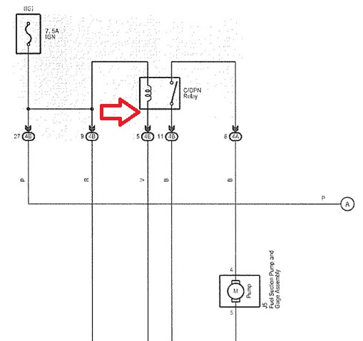

It might be valuable to back up what the scan tool is saying with a test light on the fuel pump relay during the extended crank time. Not sure what year of Yaris this is, but I picked an '07 as an example:
Find this C/OPN relay, and connect your test light to the relay ground control pin I marked. Hook your test light up to B+ so that it lights when it finds a ground. Observe the light during normal cranking, and how quickly it comes on. Then watch it during your extended crank time, and see if it isn't getting lit as quickly.
If the test light lights normally, then the fuel pump control isn't an issue. If there's a lot of cranking before the test light illuminates, then we can go towards why the pump isn't getting commanded on correctly (possible cam/crank issue like bruce.oliver mentioned).
