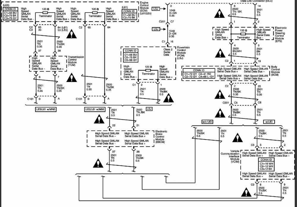

Hello all,
I'm new here and love all the info that is available being here. I'm shade tree mechanic, construction by trade...but love tinkering with cars. I would love to learn more of the diagnostic part of this mechanics trade so i have in vested in a few tools.
My reason posting is this.
2007 Pontiac G5 with 2.2L ecotech
Scan data = P0420 and U0121
I pretty much determined my cat is failing, which was caused my guess by a lean condition that poped a P0171 in this cars history. with the 171 code i found vacume leak caused by bad fuel injector orings. One repaired all good with the P0171
So all that's left is the U0121 "Lost Communication With Electronic Brake Control Module" The puzzling part about this is I have no EBCM on my car. I have checked my network and all seems good which I have only 4 of 6 possible modules. the 4 installed on my car are the ECM, TCM, BCM and PSCM. And option of a EBCM(ABS) and VCIM(onstar) would be the other 2 which I don't have.
Any Ideas??
Any more info or need questions answered let me know. Thank you
LJ

The first thing that occurs to me with the U0121 is if the PCM has been replaced previously, and was incorrectly programmed when installed. During programming, the installing software will ask what options the vehicle has (OnStar, transmission, ect.), and it's possible that someone ticked the ABS option when they shouldn't have. Now the PCM is stuck looking for a module on the network that doesn't exist. :blink:
If you clear the codes, does the U0121 come right back? Any history of module replacement?

Thanks for the reply.
I have no history of the pcm switch. After clearing codes the U0121 comes back.
Other than the cat code i have no drivability issues, trims are good o2s good. I only have done injector replacements, spark plugs, oh it did have an evap issue whitch i fixed. Likely another part of a failing cat.
Can i reprogram and will that resolve the U0121 issue?
I would likely have to go to a dealer!

Interesting... and the U0121 is setting in the PCM? Not in other modules?
I got curious and decided to go diagram surfing on this one, getting an idea of how the network is laid out. Here's what I found for an '07 G5:
Just like you found, the VCIM is optional, and the OE diagram includes the RPO numbers that go along with that option. The interesting part, though, is that the diagram doesn't show an option for no EBCM. :huh: As far as the diagram is concerned, this year of G5 HAS an EBCM. Worse, according to the diagram, it has to be there or there wouldn't be communication between the PCM and the scanner. :blink:

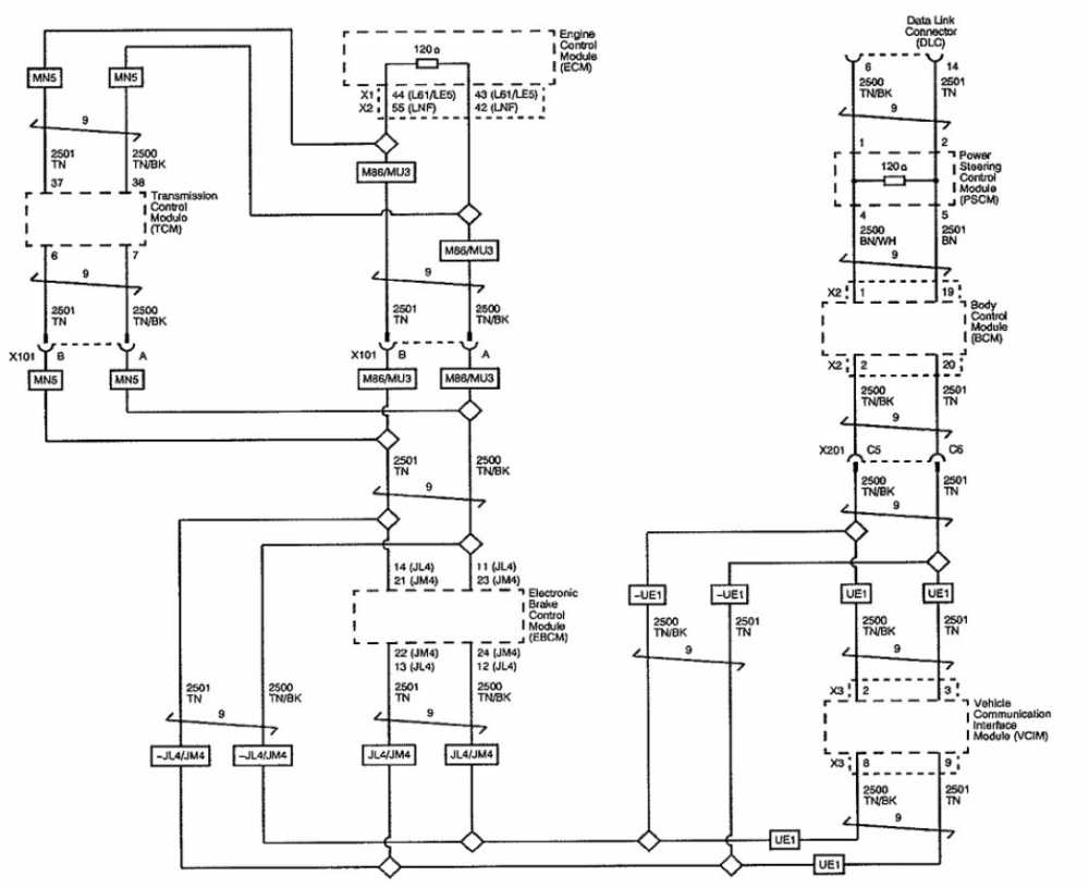

For giggles, I went one year newer and looked at the same network diagram:
Now we see an option for EBCM.
Could you check your RPO sticker, and see if JL4 or JM4 is on it? If I remember correctly, the sticker will be in the trunk, under the carpet, on the left side of the spare tire well. This'll tell us if the vehicle originally came with ABS or not.
