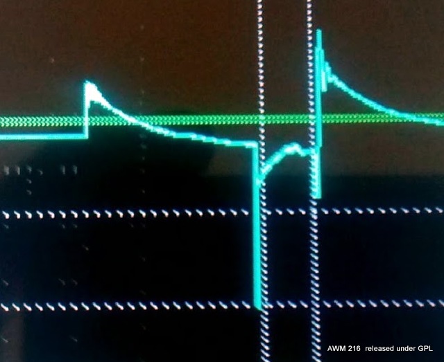

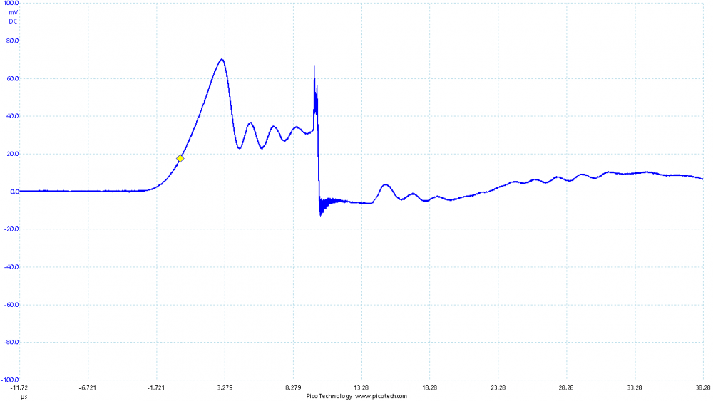

Hello, Here are some more waveforms, this time from my sisters 2016 toyota camry with the 4 cylinder engine. The secondary doesnt look like other secondaries. I wonder if the primary being in the coil interferes

Replied by Andy.MacFadyen on topic 2016 Toyota Camry Secondary/Primary ignition
My first thought was it looks like it a smoothed wave form -- check you haven't a low pass filter set in the scope settings and the sampling rate is high enough.

Replied by matt.white on topic 2016 Toyota Camry Secondary/Primary ignition
Hey Nick, was this captured using the pico paddle probe?

Replied by nick.elias on topic 2016 Toyota Camry Secondary/Primary ignition
Sorry about the delay, yes this was captured using the picon paddle probe
Did you get the filtering and aquisition setting sorted out? Check you haven't got averaging turned on, if you have it won't catch the peaks, also I think you may have captured a wasted spark.
