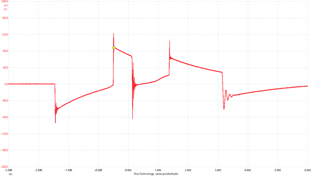

Was farting around on my truck the other day and took some known good waveforms of my 2014 F150 with 5.0L engine.
Primary Current ramp: hooked up the pico device to the ignition fuse and measured from the fuse box
Used the Pico Wyes Probe on COP:

I like that primary waveform B) It even catches the turn-on oscillations at the second ignition strike.
Do you have the .psdata file for that secondary capture? I'd love to have a closer look, as I'm interested in a COP probe that more capable than the AESWave paddle probe set I have currently.
