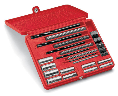

But when that fails, this set is awesome. The "Center Guides" are worth their weight in gold. Replace the right-handed drill bits with Left-handed drill bits.
store.snapon.com/Combination-Extractor-S...-Point--P630634.aspx

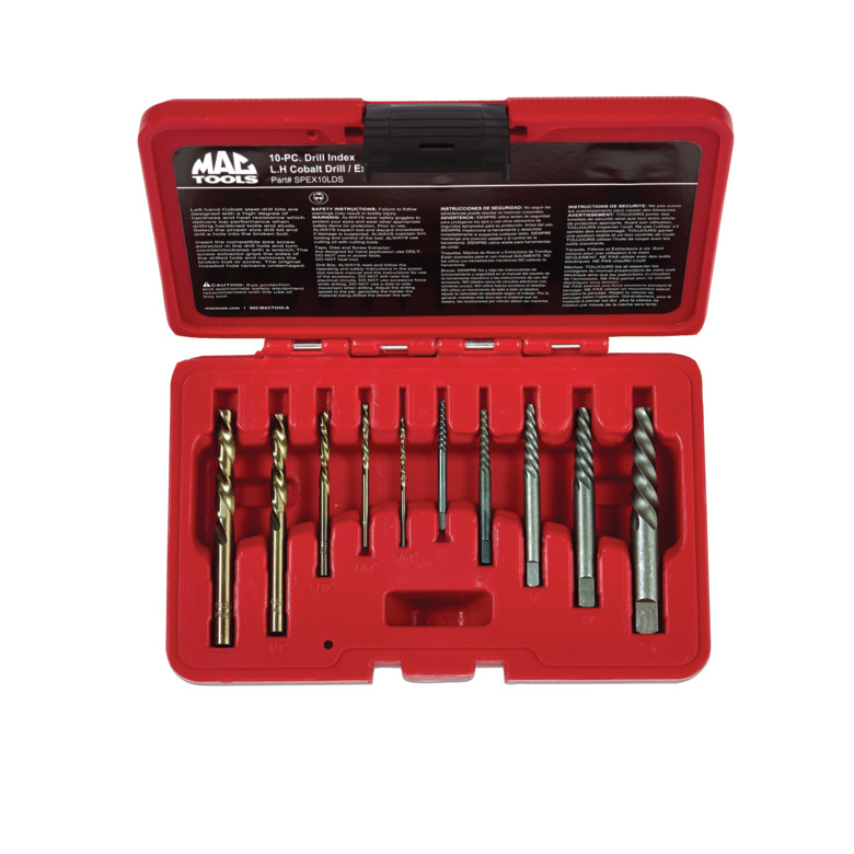

I've been using these from Mac tools with great success on smaller fasteners. The drill bits are sharp and the whole kit has a lifetime guarantee. I must have changed every bit in it twice by now, lol.
www.mactools.com/en-us/Extracting-and-Re...obalt-Drill-Bit-Set#
Like Ben and Andy, I also like the mig welder when appropriate. I'll start by welding a washer to the broken bolt, then a nut to the bolt and washer.
Also, like Andy mentioned, heating then quenching with penetrant oil works very well.
But plan your attack wisely! Sometimes heating the bolt will make it very difficult to drill if you end up needing to drill it after all else fails...
I have also had a measure of success using my air hammer dialed down to "tickle" with a soft faced brass hammer bit to kind of jar the threads lose. It can help get penetrating oil down in the threads and loosen any corrosion between the two parts.
