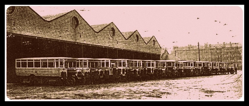

I though I kick a thread off for all those stories of cars and customers we pick up over the years, so pull up a toolbox and I'll tell you a story.
This one was handed down to me from my grandad. Just after WW1 my local city was starting to change over from electric trams to motor buses. So they ordered 14 buses, 2 each from 7 different manufacturers !. My grandad became one of the first two apprentice mechanics thery took on.
One of the types of buses was in modern terms a hybrid petrol-electric made by Tilling-Stevens.
Pre-electric starters the engines on these buses needed to be hand-cranked, not the easiest thing to do and also brings the risk of broken wrist if the ignition timing isn't fully retarded. So mostly the buses were tow or push started but because of the hybrid drive this wouldn't work on the Tilling-Stevens. It turned out my grandad was the only one in the garage who had the knack of flicking the Tilling-Stevens into life so on the times he was on vacation the two Tilling-Stevens had to be kept running 24/7 .

9 years 11 months ago #3370 by matt.white
Love the stories boys.
The bus one is crazy Andy. I can't imagine how different from each other they would have been. Would have been difficult to become familiar with any of them.

matt.white wrote: Love the stories boys.
The saving grace was things were pretty simple in those days generally sidevalve either T or L head, magnetos were pretty much the same across the board, single jet carbs. Where they had electrical systems the dynamo field charging was controlled by a simple on off switch they called the "cut out".
Fuel was supplied either by pressurising the tank by hand pump or a device called an Autovac that used manifold vacuum to fill a header pot, and of some like the Model A simple gravity feed.
One of Jay Leno's you tube video give a pretty good idea of what mechanics were dealing with it is a Cadillac but the tech is pretty much as you would find in lower end cars and trucks of the era.
