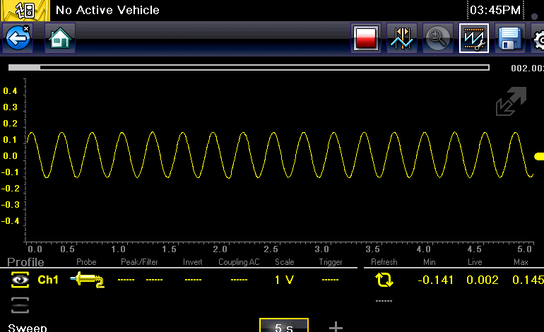

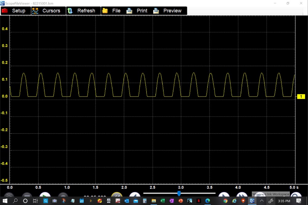

So, I don't know how many of you have experienced this issue but considering the cost of Snap-On Software subscription's I really feel it needs to be addressed. Early last Summer I bought a Snap-On Vantage Ultra with the Software 21.02 installed and noticed that when saving recordings, the software would cut a sinewave signal in half at the zero volts line and only show the wave pattern above the Zero line.
Good wave form vs bad recording
when looking at the signal live it was normal but when saved in memory the play back only showed the positive side of the signal. The issue was both with playback on the scope itself and in the saved recording downloaded onto Shop-Stream connect as well.
Then I traded my Vantage in for a Modis ultra also loaded with 21.02, and the issue was the same as on my Vantage. So now I reasoned the issue was software related and not a fault of my scope.
I called Snap-On tech support about this back in August 0f 2021, and they replied that they had heard a few instances of the issue but that they were not clearly understanding what the issue actually was. I sent them screen shots and recording files along with a description of how to reproduce the fault on the Snap-On demo board. They assured me after viewing these that they would forward the issue to their software engineers for a software patch repair...

I have a Triton D8
This has been corrected with the 22.2 update.
The tool used to save scope captures in the VSM format. It was slow, but easy enough to take apart and turn it into a CSV.
Without warning or consent, they changed the file format to the LSM format which is faster, but was screwed up. So far I've not figured out how to turn it into a CSV and they won't help.
