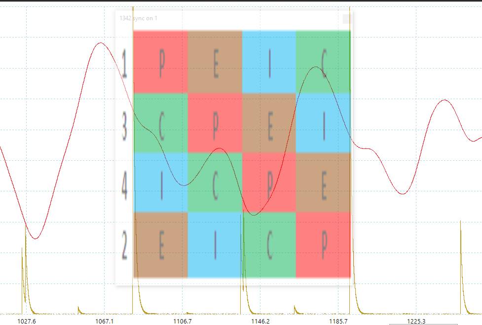

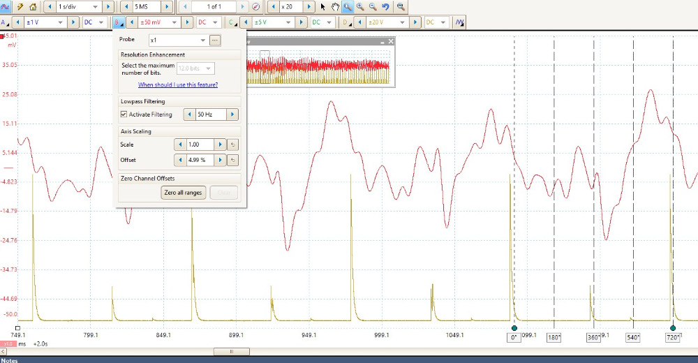

Okay, guys and gals. It's time for another round of "Guess Which Cylinder!"
2002 Chrysler PT Cruiser 2.4L Blown Head Gasket
Firing Order 1-3-4-2 Sync on #1
Use these waveforms to take a guess at which Cylinder is at fault. B)

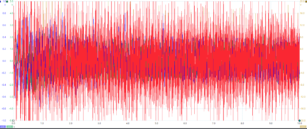

Building on Tyler's game, this time, you will need to use Filters, Zooming, and a Math Channel (RC is Voltage with AC coupling, it will need to be inverted) to "tune" the waveforms in. Here is a Screen shot of an "un-tuned" capture.
You should be able to produce, and post screenshots, of useful waveforms to determine which cylinder(s) is/are at fault.

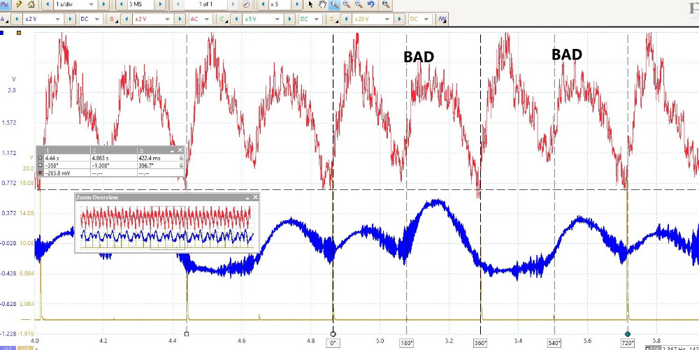

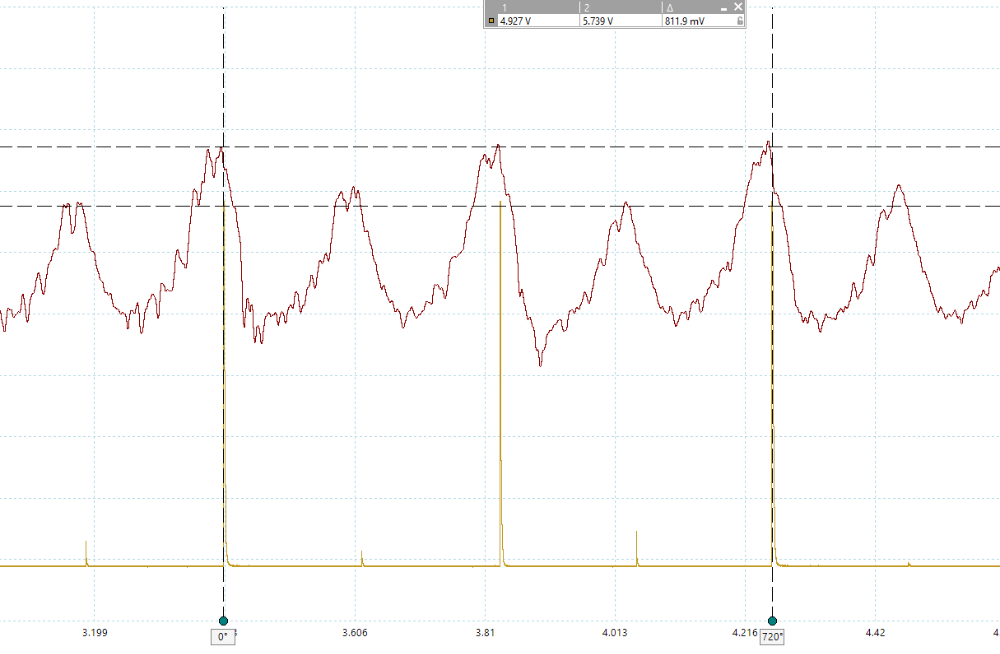

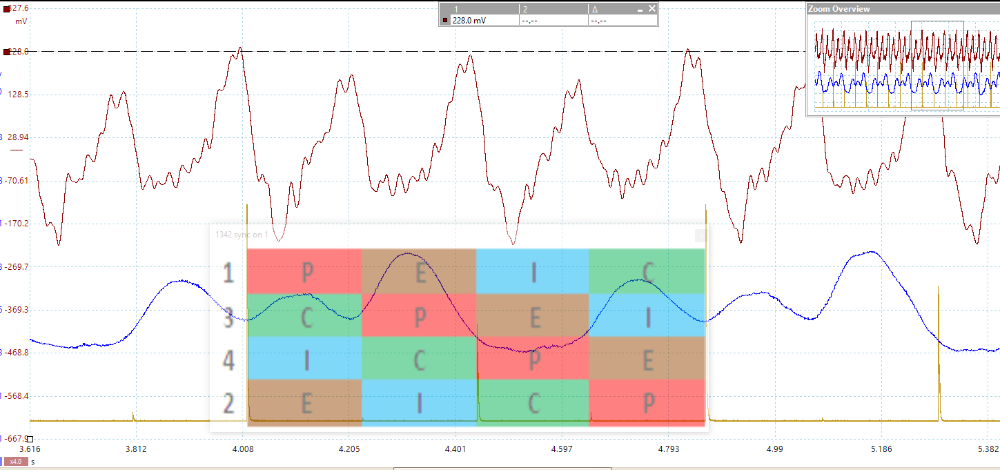

5 years 10 months ago #45446 by Matt T
Replied by Matt T on topic Blown head gasket...Which cylinder?
Applying a heavy low pass filter to the radiator pulses at idle makes it look like cyl #2.
5 years 10 months ago #45447 by Matt T
On the cranking waveform #2 definitely looks bad. Compression peak isn't terrible on #3 but the bounce back looks as bad as #2. And #2 and #3 both appear to be causing pressure rises in the rad.

5 years 10 months ago - 5 years 10 months ago #45448 by Chad
Replied by Chad on topic Blown head gasket...Which cylinder?
Matt T wrote: Applying a heavy low pass filter to the radiator pulses at idle makes it look like cyl #2.
Nice! :) With even MORE filter, you can see another significant event.

5 years 10 months ago - 5 years 10 months ago #45449 by Chad
Matt T wrote: On the cranking waveform #2 definitely looks bad. Compression peak isn't terrible on #3 but the bounce back looks as bad as #2. And #2 and #3 both appear to be causing pressure rises in the rad.
You are, exactly, right. And, I am sure you know, Matt T. But for others, keep in mind that this is a voltage waveform. It is upside-down for RC. On this 4 cylinder engine and Firing Order, It looks similar to the invert. However on a 6, or 8 cylinder engine, it can look quite different.
To flip it, Go to Tools/Math Channels and check Invert B.

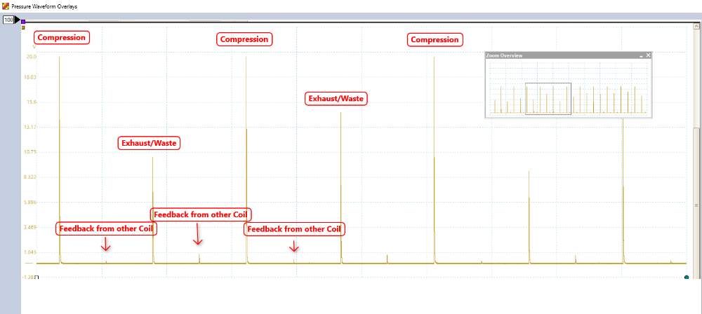

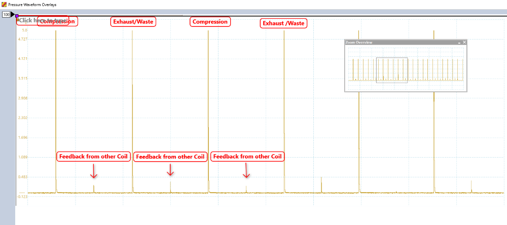

Weycraze,
The ignition signal is waste spark taken with an inductive (RPM) pick-up. The firing events are taller than the waste sparks with this type of probe. It's a little difficult to see with this capture because the voltage scale has cropped the top off the firing events.

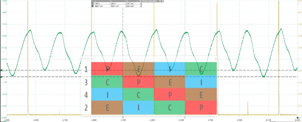

  • Chad's Avatar Topic Author
5 years 10 months ago - 5 years 10 months ago #45463 by Chad
Tyler wrote: Awwww I missed out on all the fun. :( :lol:
No one has posted a screen shot of the Intake Manifold waveform, yet. There is something to be seen and explained there, as well. B)
Matt T wrote: The ignition signal is waste spark taken with an inductive (RPM) pick-up. The firing events are taller than the waste sparks with this type of probe. It's a little difficult to see with this capture because the voltage scale has cropped the top off the firing events.
Spot on, again, Matt. ;) This was a error, on my part. :dry: The voltage scale was set to 5 volts, when a minimum of 20 volts should have been used. (This error would not be an issue with the eScope.) The scaling was changed for the other captures.
5 years 10 months ago - 5 years 10 months ago #45475 by Chad
Weycraze wrote: Thanks Chad, nice set-up!!!!
:oops: My apologies, Paul. It wasn't intentional. :blush: I'm going to blame it on the eScope. :dry: I have gotten use to skipping the channel/scaling setup. ;)

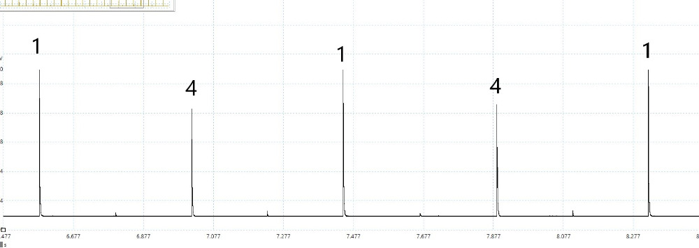

For those that missed it, my bad voltage scaling, in the first waveform, can make 360° of Crank Rotation appear to be 720° of crank rotation.
Bad Voltage Scaling:
Cylinder #1 Compression Spark and Exhaust/Waste Spark both spike over the 5 volt scale. The feedback from the other coil appears to be the waste spark event.
Better Voltage Scaling. With a 20 volt scale (could have been even higher), we can see Cylinder #1 spike higher on it's compression stroke than it does on the the Exhaust Stroke/Waste Spark
Last edit: 5 years 10 months ago by Chad.

5 years 10 months ago #45548 by Donut
Replied by Donut on topic Blown head gasket...Which cylinder?

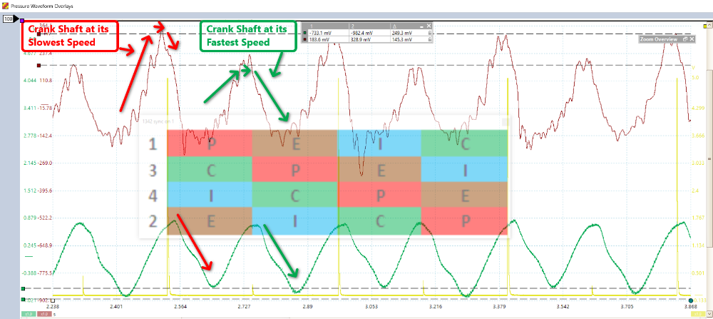

Chad wrote: No one has posted a screen shot of the Intake Manifold waveform, yet. There is something to be seen and explained there, as well. B)
From the looks of it cylinders #2 and #3 have a deeper intake pull than the other two due to a loss of cylinder charge through the blown head gasket. Use that with the RC and radiator pulse waveforms and you've got a pretty solid case there. Definitely a useful tool in proving out a bad gasket, and somehow a step I always seem to forget about when the time comes to use it. :whistle:
5 years 10 months ago #45554 by Chad
Donut wrote: From the looks of it cylinders #2 and #3 have a deeper intake pull than the other two due to a loss of cylinder charge through the blown head gasket.
Close. You're on the right track. ;) However, loss of (volume) charge through the head gasket would not affect the intake stroke, as the exhaust stroke occurs in between. I would argue that the reason for the un-even Intake pulls is due to the crank shaft speed. Under LOW compression, the crank shaft speeds up, causing a DEEPER intake pull on the cylinder that is, simultaneously, on it's intake stroke. Likewise, under GOOD compression, the crank shaft slows down, causing a LOWER intake pull on the cylinder that is, simultaneously, on it's intake stroke.
5 years 10 months ago #45559 by Donut
Ah crap, you got me. I was thinking of the deeper vacuum pocket at the bottom of an expansion stroke with in-cylinder pressures.
