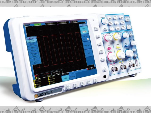

Is there a reason why we dont use standard labs scopes in auto repair? I mean scopes like Rigoll, UNI-T Keysight etc some of them seem to be half the price of a similar picoscope while being much higher speced and without the concern for USB connectivity problems. Very interested to get some input on this before I go out and buy a scope.

Bench scopes with the main exception of some of the Owon models are hampered by the need for mains power supply. Even on the Owon SDS with the optional battery pack especially the faster models the length of time working on battery power is limited --- considerably shorter than the manufacturers claims.

On the otherhand if you want a simple starter level PC USB general purpose scope at a bargain price checkout the Owon 11022i --- it is a lot better than the Hantek 1008 but will need input attenuators for checking coils and injectors

Probably the cheapest useful scope Owon VDS1002i (note the i suffix) --- PC software is really nice to use, surprisingly performance at 25mhz per channel isn't over claimed by the manufacturer. A lot of Chinese scope manufacturers might claim say 100mhz but in reality that is closer to say 50mhz and the processing hardware is shared between channels so the more channels you run the slower the performance of the scope.
www.owon.co.uk/product-page/vds1022i-25m...uEDySoFHrRKUtSWMHBeQ
