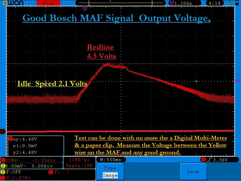

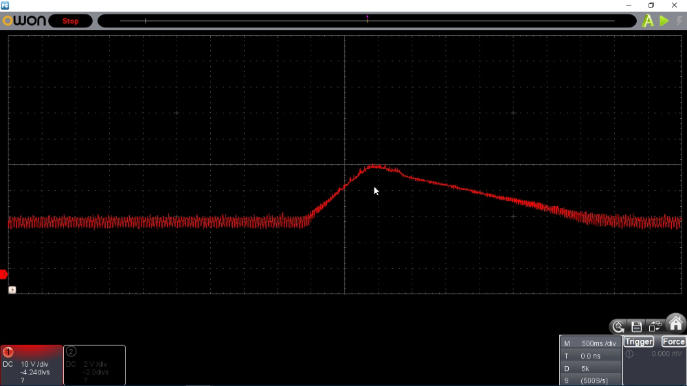

This is the screenshot capture is the capture using the VDS1022i from a Bosch analogue hot bead MAF test on a Turbo Diesel ---- NB very different characteristic from a gasoline engine
This is my known good captured with a much more expensive Owon scope.
