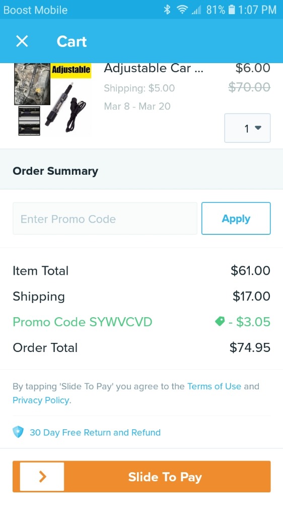

7 years 9 months ago #26899 by juergen.scholl
Replied by juergen.scholl on topic Cheap Graphing Multimeter
shipping cost states $ 229 to U.S., delivery some 5 to 7 weeks.

7 years 9 months ago #26913 by Noah
Replied by Noah on topic Cheap Graphing Multimeter
juergen.scholl wrote: shipping cost states $ 229 to U.S., delivery some 5 to 7 weeks.
:woohoo:
HA! Should have looked into it better, lol.
7 years 9 months ago #26914 by Noah
IDK, looks like it wouldn't cost much to ship it

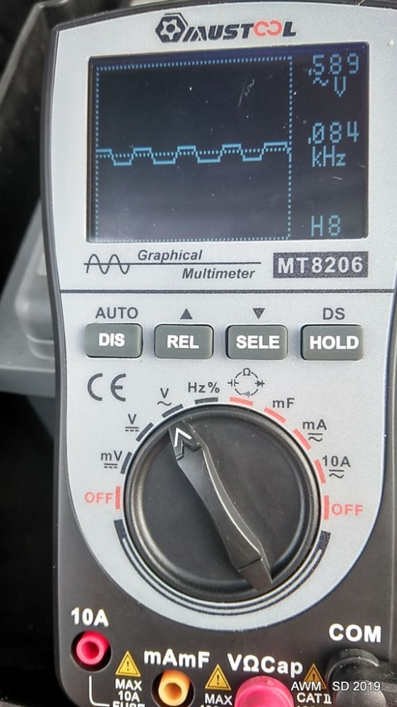

7 years 9 months ago - 7 years 9 months ago #27063 by Andy.MacFadyen
Replied by Andy.MacFadyen on topic Cheap Graphing Multimeter
It arrived an hour ago --- first impressions nice bright display, case material feels okay , it takes 3 AA batteries, the switch feels a little vague.
Nice unexpected feature is the oscilloscope works on the 10a ammeter setting.
First trial was to connect it to the 1khz 5v test output on my Owon labscope ---- no problems on AC setting nice square wave.
Next I tried to do a cranking voltage test --- At this point I hit on a snag the in both Multimeter and Oscilloscope modes it goes into straight into auto-ranging for both voltage and time-base with a lack of any user control for volts scale, also it behaves quite differently on the AC setting from the DC in DC mode it is definitely graphing meter in AC range it is an oscilloscope
On both the AC and DC scales the voltage ranges are 400mv (separate socket) and 4v, 40v and 400v on the main --- far from ideal for 12v light vehicle work. As a result was initially unable to capture a usable cranking voltage using the either the AC or DC settings. However using the DC settiing together a test lead I had made up for use with a Hantek scope with a capacitor to block the DC part of the signal I got a really nice usable capture.
I will do more tests over the next week or so and keep you guys informed.

7 years 9 months ago #27066 by Andy.MacFadyen
I tried it on a 5v Hall Effect cam sensor --- 1 pulse per camshaft revolution. dc setting just T pinned straight into the signal pin I don't think it is fast enough to be useful on a crank sensor.

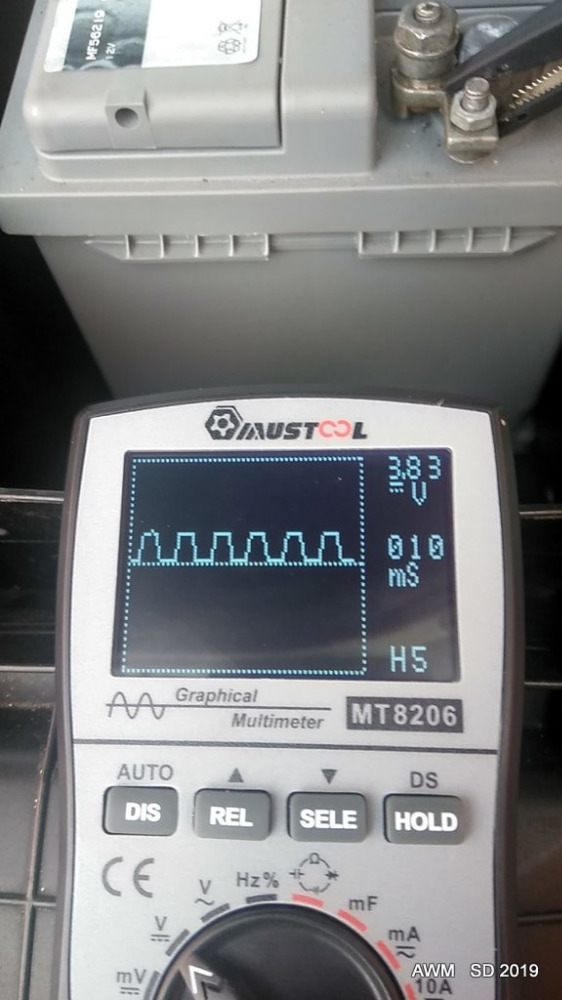

7 years 8 months ago - 7 years 8 months ago #27088 by Andy.MacFadyen
On a Bosch hall effect active ABS sensor

7 years 8 months ago #27119 by Andy.MacFadyen
The main flaw in my book is is a lack of user controls? I will probably keep it my daily driver with my cheapo ELM327 Bluetooth dongle and use my UT-203 and BT35 as my working DMM. However I want to try it in graphing ammeter mode on a slow time base for parasitic drains.
