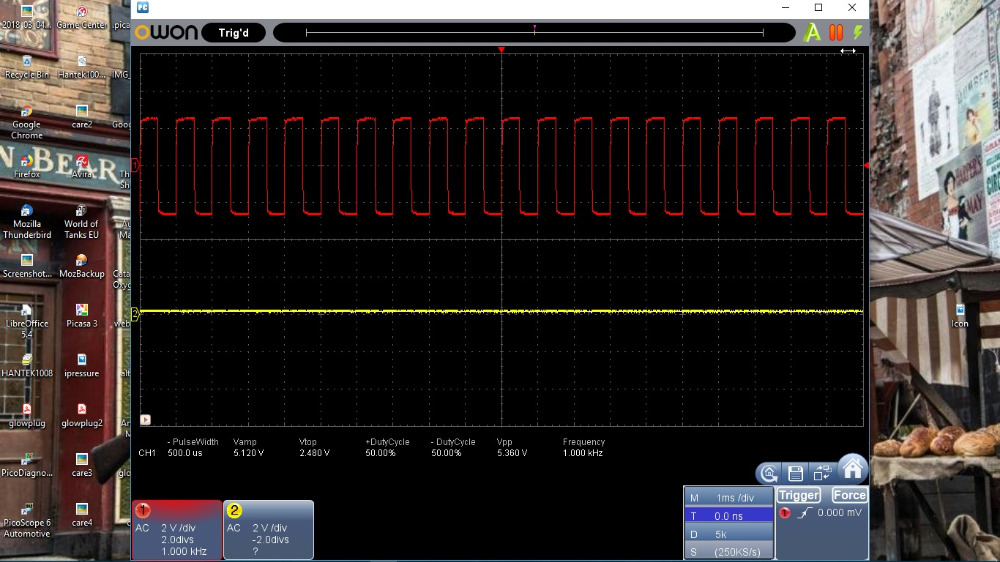

The scope was delivered yesterday, weather has been wet and windy so no real chance to evaluate it properly but I can say that there is much less noise on the signal than any comparable Hantek scope I have seen. The user interface is some different from other scopes I have used but looks much better than either the new or older Hantek software interface and the main controls have simple keyboard shortcuts.
Good points :
Difficulties
Good points :
- Much less noise than Hantel 1008
- Hardware has a higher quality look and feel
- Simple easy keyboard shortcuts
- Software interface looks proffessional

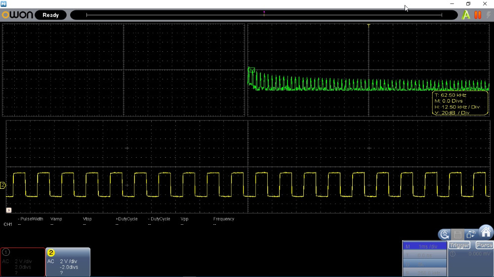

- FFT fuction works well
- FFT & Math Functions can display in windows above source channel
- Record/playback function works well
- Save screen as image works well
- Peak Detect works nicely
Difficulties
- As yet I can find no way to store pre-sets but on start up it reverts to previously used setup at last switch off
- Single Trigger Capture function on works on time/division less than 250ms, --- work around is to use record and playback function
- This is an entry level scope don't expect a fast or powerful scope but is much better value for money than the Hantek
- Interface has a learning curve although an experienced scope user it took me a bout 3 hours before I felt confident with it.
- Howto save a reference waveform took a bit of head scratching.
- Probe settings available on 10x, 100x & 1000x NB no x20 or current clamp settings or custom probe settings This isn't a major issue

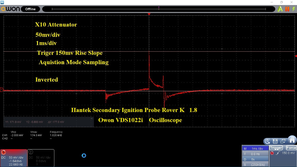

Replied by Andy.MacFadyen on topic OWON VDS1022I Storage PC Oscilloscope 2 Channel
To get a secondary ignition capture needed an x10 or x20 attenuator - The spark was an negative spark and I found the only way to set the trigger was to set it to give a stable trace before inverting the on screen trace. Although the scope software lacks an x20 probe setting my choice would be to use an x20 attenuator on the x10 setting and simply multiply the readings by 2.
Otherwise I am really starting to like this scope and I would like to get my hands one of the more advanced faster Owon VDS scopes to try
