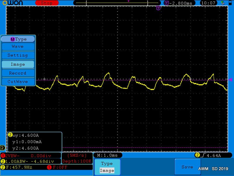

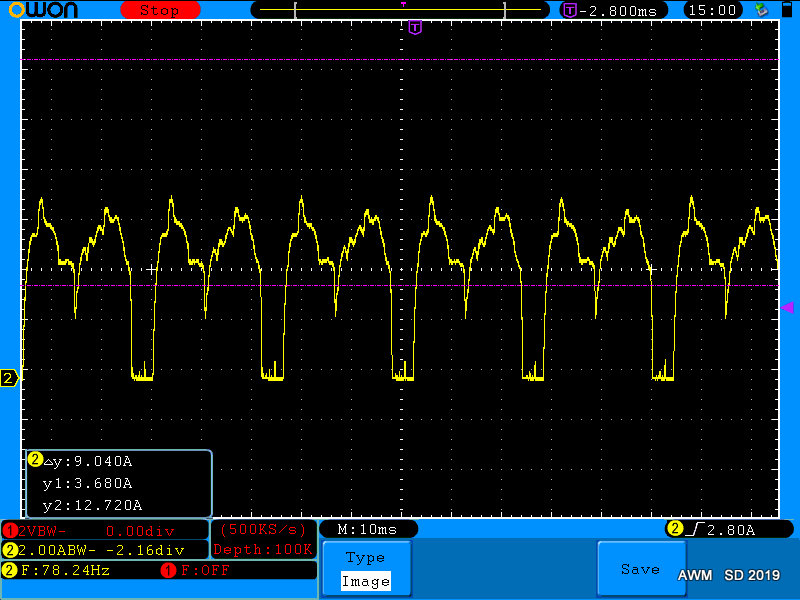

Common Rail Diesel Under Hood LP boost pump --- occasional non starting.
  • Andy.MacFadyen
7 years 10 months ago #26136 by Andy.MacFadyen
Replied by Andy.MacFadyen on topic This was slam dunk why you need a scope & amp clamp
New pump

Well done young man,its easy if you can and very non intrusive,what vehicle was that on?

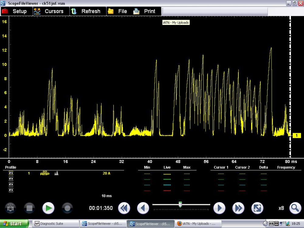

Here,s a td 5 bad pump
  • Andy.MacFadyen
7 years 10 months ago #26139 by Andy.MacFadyen
Landroverman1958 wrote: Here,s a td 5 bad pump
Nice one ROTF ---- absolute cracker

Landroverman1958 wrote: Well done young man,its easy if you can and very non intrusive,what vehicle was that on?
Yet another Rover 75 ----
