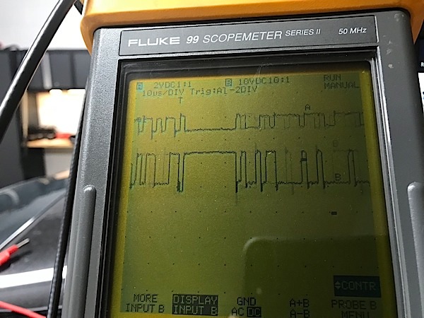

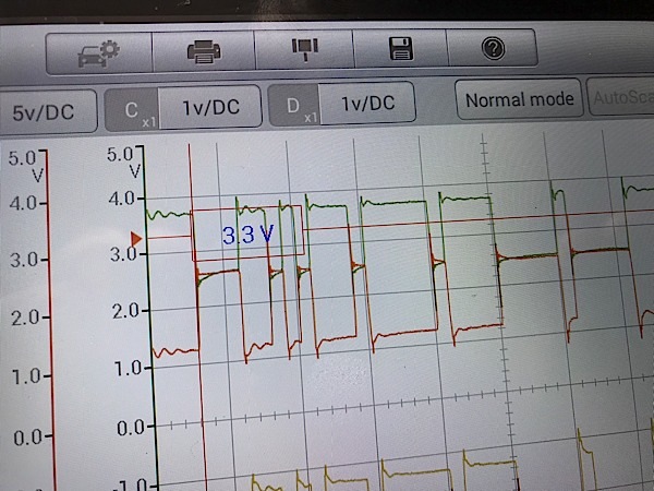

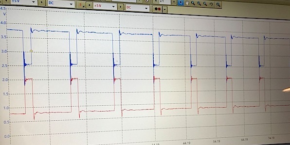

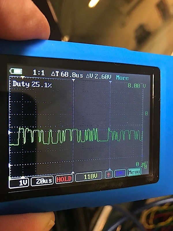

I have to agree that pocket DSO have their limits. They are good at confirming a signal and maybe shape but not measuring the waveform. For example, here is a CAN Hi and Lo signal on a UScope (One channel=one CAN signal at a time), Autel MP408 (Hantek), Fluke 99 (channel a 2:1 probe setting, opps!) and Pico Scope. Most of these were just auto setups and not too much refinement. The Uscope is great at somethings, but should not be used to make the final call on all things. As a learning device, pocket DSOs are great for learning about triggers, scales and setting up a scope.

I wouldn't even have considered looking at CAN Bus with a uScope/DSO 201 Nano I am actually surprised it produces an almost recognizable trace :-) it isn't a substitute for a fast multi-channel with deep memory for that kind of work but for quick fault finding. I carry mine in my daily driver, along with a cheap OBD2 dongle
