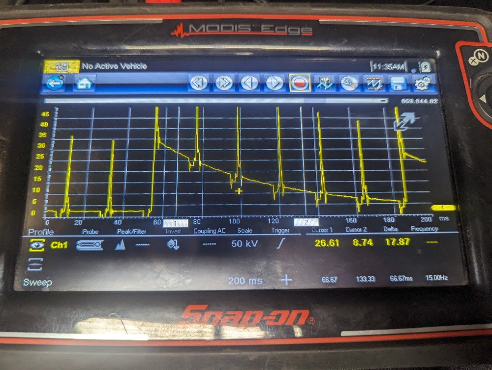

Hi everyone, I was hoping someone might be able to tell me if I have something set incorrectly on my Modis Edge. This capture is off a 1996 Silverado 5.7l. I have the pickup probe place between the coil and distributor cap. What is causing this pattern to have this slope? If I zoom in the capture looks great but why is it sloping down from 35kv? Any help would be greatly appreciated. Thanks!

That is a very nice capture.
What you see is normal, the reason for that spark firing up so high, is due to increased resistance.
What is important in this case is that the firing KV ( Point of Plasma ) AND the Burn Time are the same as the others. And in your case it is it looks pretty good.
On distributor engines this is common, BUT it can also occur on COP systems too/

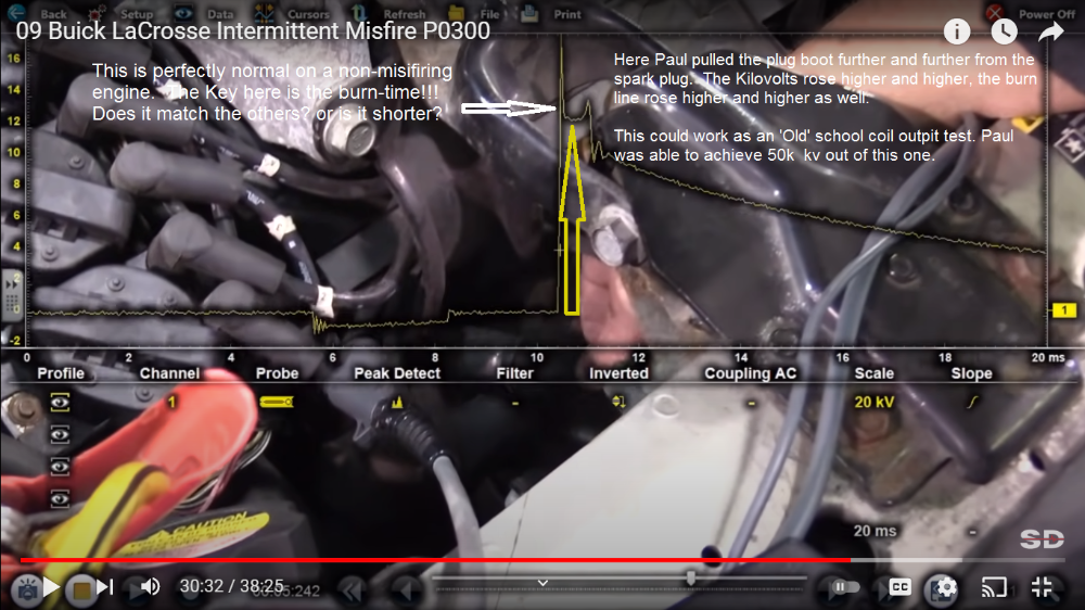

This is an excellent capture too, from one of Mr. Danner's videos.
Here Paul is creating resistance by increasing the air gap, this put a heavy load on the coil and it is forced to output as much as it can.
If you noticed this everytime and the same plug, then there is an issue.
