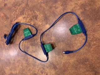

4 years 11 months ago #52915 by Mechanic 350
Here’s what I have Tyler. I never used it. It belongs to my old modis. Will it work if I use it for my vantage pro?

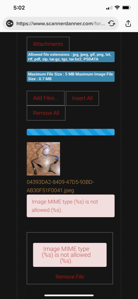

4 years 11 months ago #52917 by Mechanic 350
Tyler the website is not allowing me to show you the tools. I can’t upload the pictures

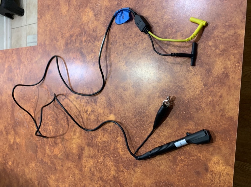

4 years 11 months ago #52920 by Mechanic 350
Pic # 2

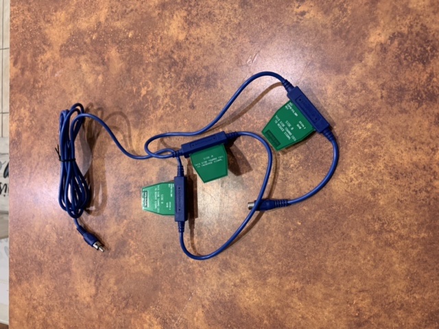

4 years 11 months ago #52922 by Mechanic 350
Pic 3
This is what I have. Will it work?
4 years 11 months ago #52923 by Tyler
Pic #3 is designed to work with ignition wires. Probably won't generate a useable waveform? No harm in trying it anyway.
The other COP flags may of be of use, though. You'd have to add a couple of these to look at all eight cylinders:
shop.snapon.com/product/VERUS-PRO-Access...-Adaptor/EAC0056L00A
You can also look at these COP 'sticks':
shop.snapon.com/product/Multi-Cylinder-S...-Adaptor/EAC0056L03A
Lastly, you'd need this kit, specifically the banana jack to RCA adapter:
shop.snapon.com/product/Secondary-Igniti...Lead-Kit/EAK0294B09A

4 years 11 months ago #52924 by Mechanic 350
I have that last kit Tyler.
I should just purchase that Waze probe from aeswave and call it a day. $139
4 years 11 months ago #52927 by Tyler
I probably would. :lol: Or make your own and experiment! A lot cheaper, plus you can customize it to your needs. I get way more use out of my homebrew probes than the ones I purchased.
