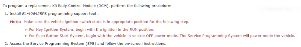

All the GM modules I've programmed didn't require the ignition to be off when beginning the programming event.
For giggles I checked Control Module References for the Radar Sensor Module - Long Range going back to 2015. The 2014 MY didn't list the same module available. Every year for 2015 and up says key off for programming.
Many other modules simply tell you to hook up SPS and follow the on-screen instructions. :silly:
For a BCM, there's this little notation:
It would appear to me that the whole key on/off thing has less to do with the model year, and more to do with the module in question. Service info is your friend on stuff like this.

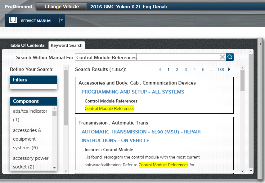

I was a little curious about that myself! I had not idea it was even possible to program with the key off. You mention reading service data and I agree, but we only use ProDemand no IdentiFix or OEM service info and it seems like Prodemand doesn't go very into depth for programming instructions. Or am I not looking in the right place?
- Posts: 6129
- Thank you received: 1545
4 years 10 months ago #52077

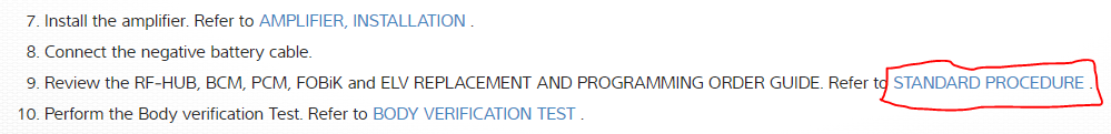

Most DTC documents also include a link to the same thing. Other makes aren't as easy.

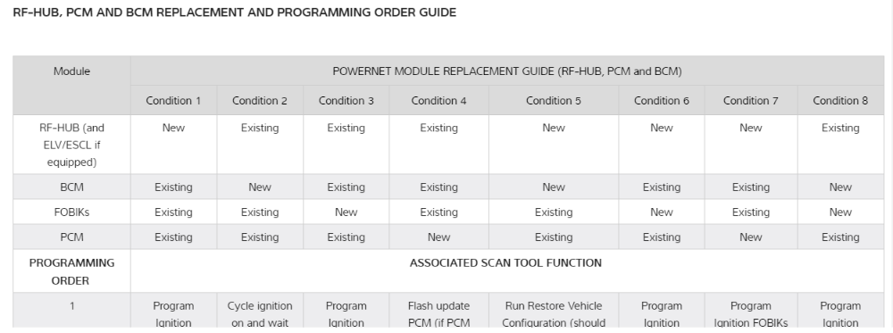

Usually I'll look up the R&R procedure for the module I'm working with and get a better idea of what's required. For example, RAM provides this chart for what to do after BCM/PCM/RF-HUB replacement:
Replied by Tyler on topic Gm module prigramming
GM has Control Module References, which is their (very convenient) playbook for module replacement. There's probably a faster way to find it? But I usually just go for a keyword search:I was a little curious about that myself! I had not idea it was even possible to program with the key off. You mention reading service data and I agree, but we only use ProDemand no IdentiFix or OEM service info and it seems like Prodemand doesn't go very into depth for programming instructions. Or am I not looking in the right place?
