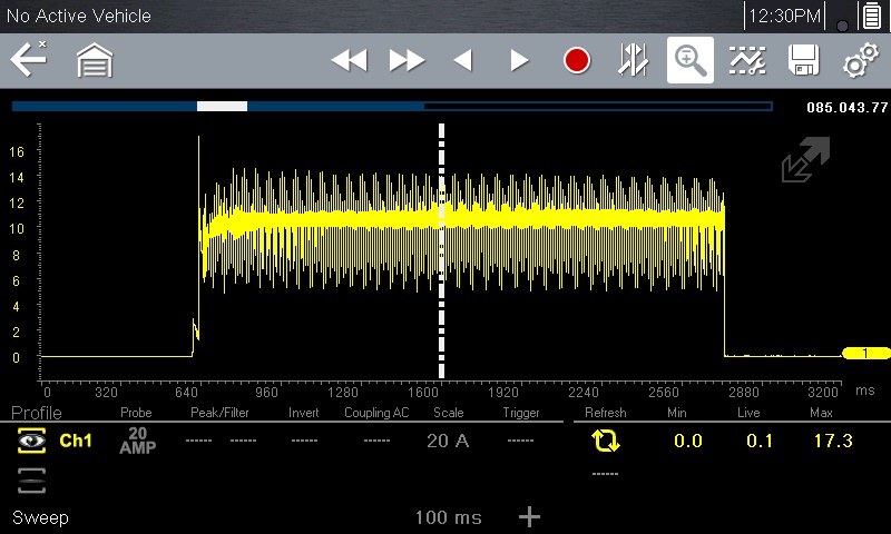

I brought this up to the group chat awhile ago, but wanted to revisit it with the community. Around here, when a vehicle comes in with an inop HID headlight, it can become a mess. :silly: Try a known good bulb, then sell a new headlight assembly or HID module when that doesn't fix it. It goes from cheap to $$$$ quickly.

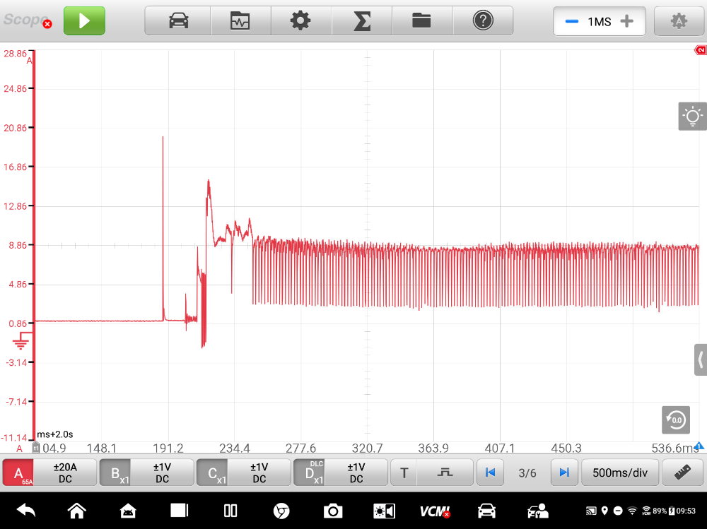

What's the better way? I started playing around with a used Subaru HID headlight assembly for giggles. Headlights themselves are becoming more and more inaccessible, so I figure it'd be awesome if we could use a current probe at a headlight fuse to do our testing. :) I hooked up our test headlight and got a current waveform during normal, working operation:

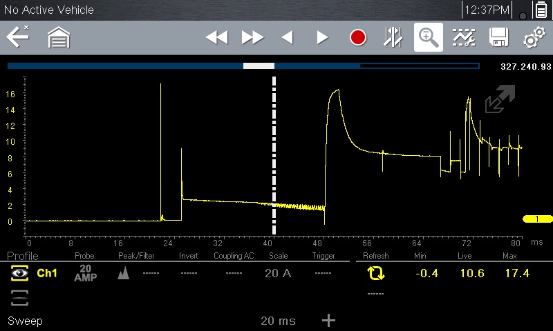

And here's a zoomed in view of the bulb 'lighting off' for lack of a better term. I don't know HID bulb operation like I should. :blush:

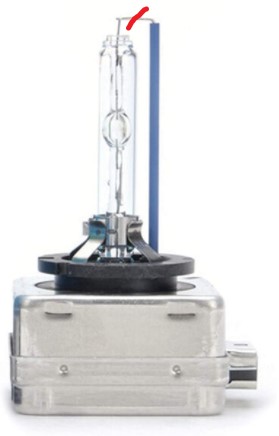

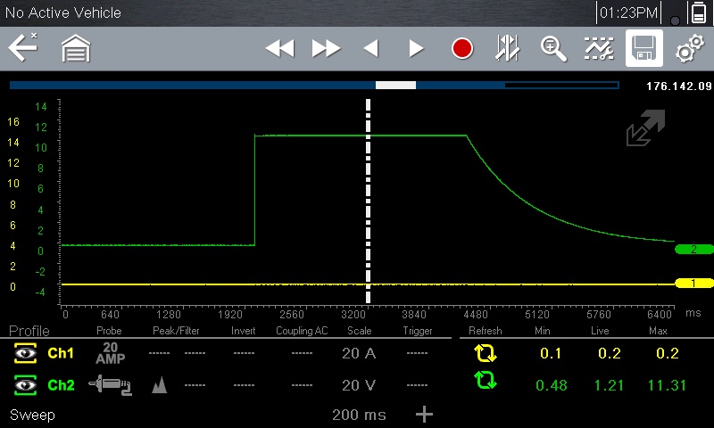

So we know how much current a working bulb should consume. Great. Now I cut the outside of the electrode to simulate an open bulb. I added a voltage trace on channel #2 to show when voltage was applied.
It would seem to me that the HID ballast/module is trying to light the bulb off, fails, then gives up. :silly: This behavior was repeatable. I don't know about the internal construction, but there would seem to be some kind of logic at work.

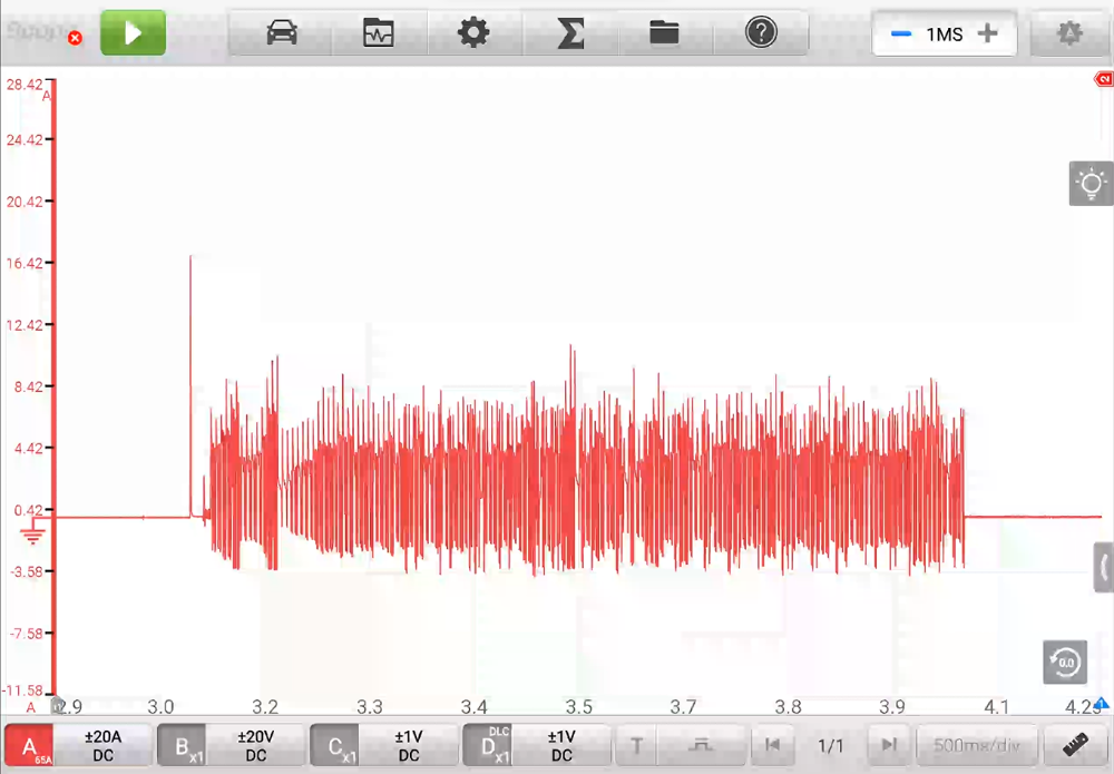

Then for giggles, I damaged the module itself, and retook the capture:
Can we infer that, if we see an attempt by the module to ignite the bulb, that the module is good? And that power/ground to the module is good? I'd welcome your thoughts.

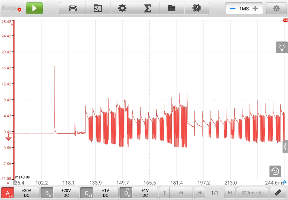

Good question! I took this capture off an '05 Acrua TL with inoperative headlights:
Based on previous experience, I took a shot that the bulb was blown and that the rest was OK. Customer took the vehicle. Never got to fix it. :(

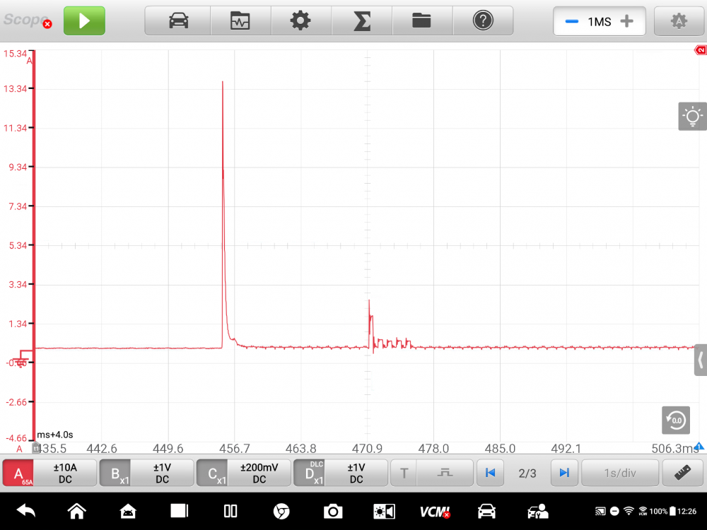

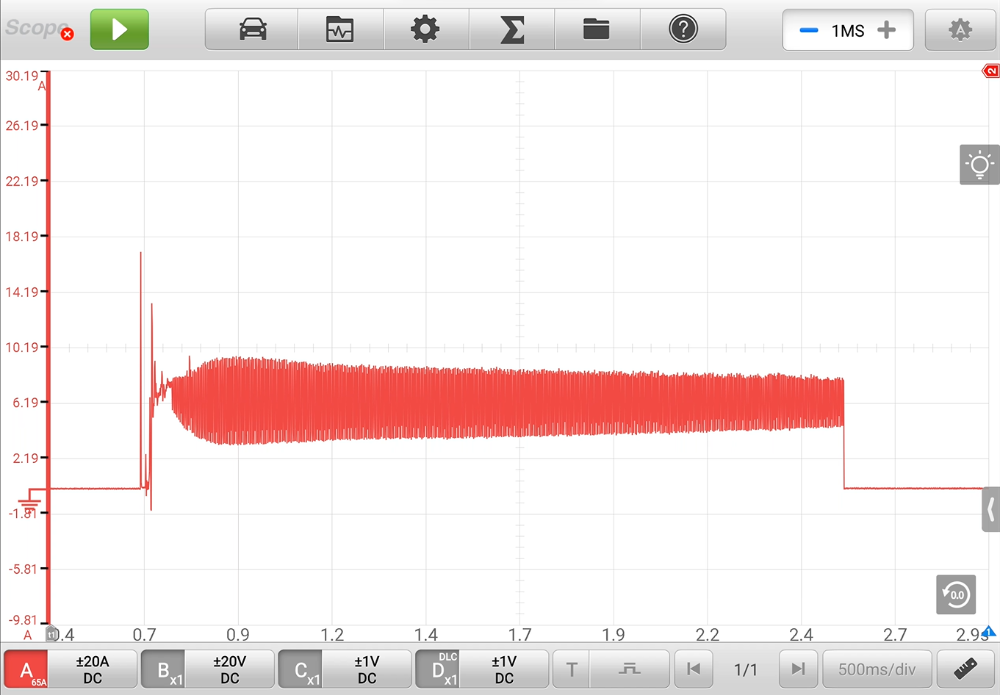

Another example off a 2011 Acadia. The left front is working correctly:
The right front is not:
Zoomed in, it appears the ballast keeps trying to light the bulb and can't do it:
I'll follow up when this gets a new bulb next week.

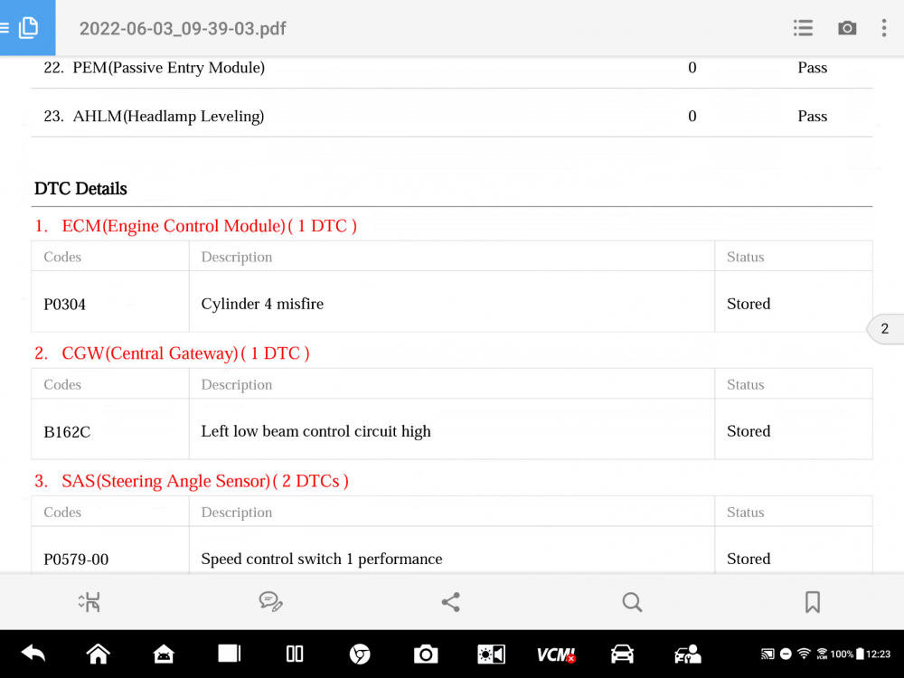

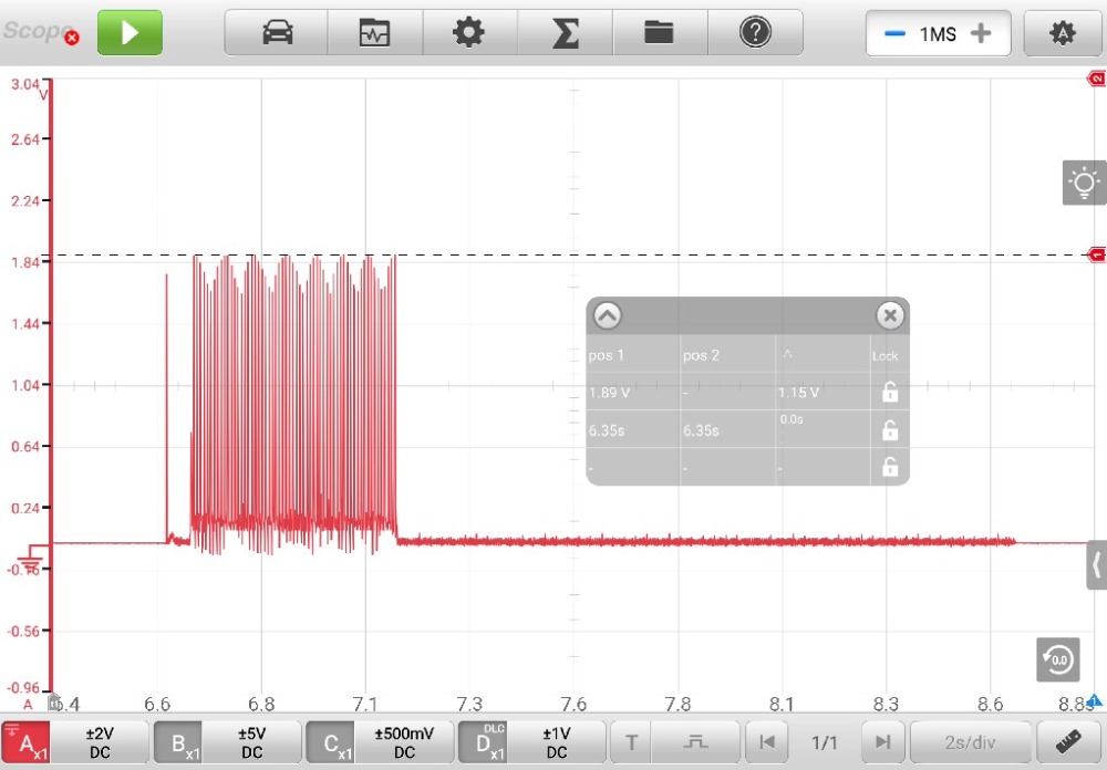

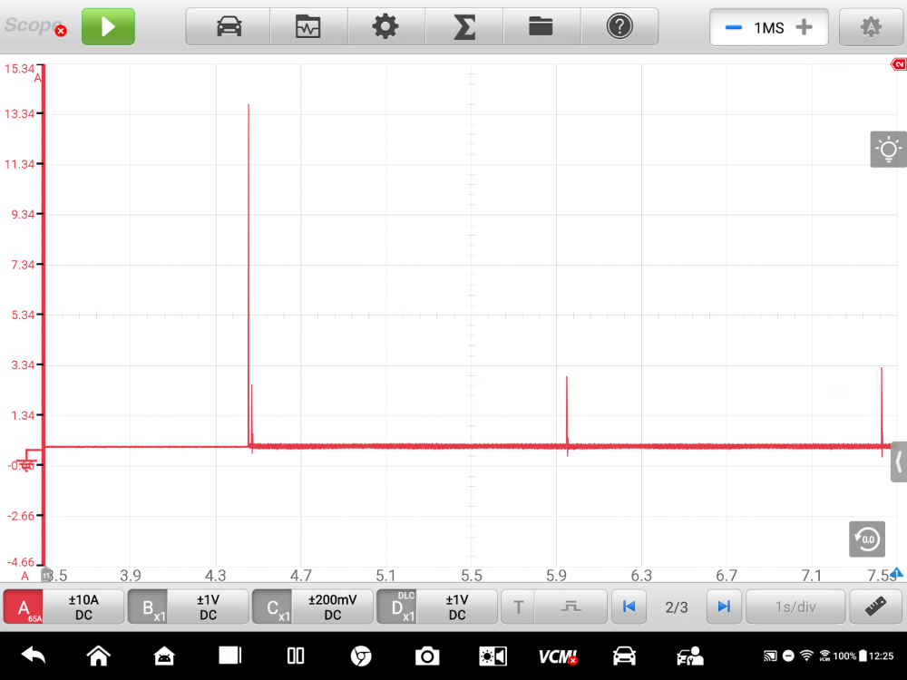

2011 Grand Cherokee 3.6L comes in with a complaint about the headlights. Left no workie, right is fine. B162C backs up what we already know.
Zoomed out shows a strong in-rush spike, followed by...very little. Some noise, really. Customer has already put their own bulb in it. I suspect the ballast is smoked. As in, it's not capable of igniting the bulb.
