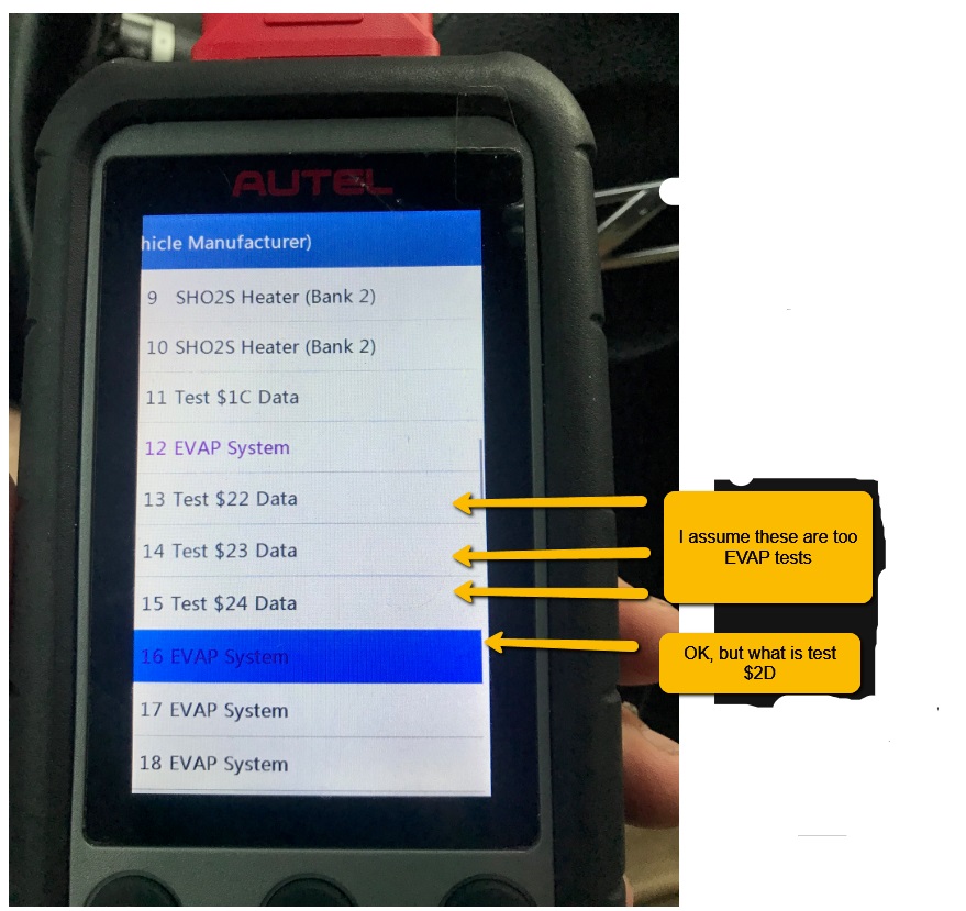

So I have an Autel 806Pro and frankly I'm disappointed how long it takes to talk to any of my cars....but that is a different problem.
My current pressing issue, is that when I get to monitor test screen it doesn't tell me an english words, rather it gives me some hexidecimal code.
For example of the many tests is list some tests with the words EVAP System, then some words like "Test $22 Data","Test $23 Data"

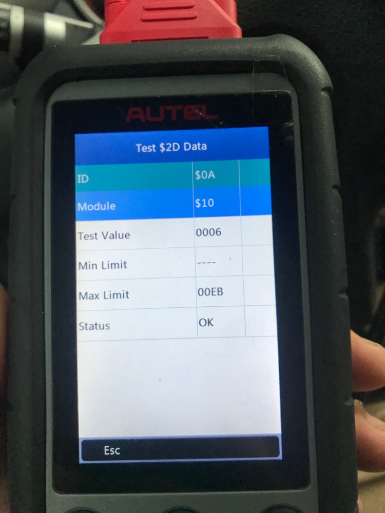

One of the "EVAP System" options I saw, after clicking it comes back with a screen that states this test is $2D, and ID of $0A and Module $10....a test value of 0006, Min limit ----, Max limit 00EB (which I can only assume means a value of 256), Status = OK....so yeah that's great that it passed.....BUT WHAT was tested and what are the values? Ohms, volts, psi, inhg?
Where does one find the meanings?
Is there a better tool I should use ? Getting frustrated.

The hex information you see is OBD 2 mode 6 raw data. You'd need a factory service manual that decodes the TID (test ID), MID (monitor ID) and so on to get a clear understanding of the exact meaning of a specific test and its scaling. Each manifacturer is free to use its own designations, algorythms etc.
There are some scantools out there that will translate the hexcode into meaningful English, the e-scan from automotive test solutions comes to mind which covers most of the domestic vehicles.
Actually Autel in my opinion does a pretty decent job in deciphering mode 6 raw data, but this goes for the professional grade series. The costs for accessing/researching these informations makes it almost impossible to obtain these services within the DIY/entry level tools, I think.
$10 is a frequently used designation for the ecm/pcm.

The TID in the screen shot is $2D
The MID or CID in the screen shot is $10
Right?
What is the ID $0A ?
