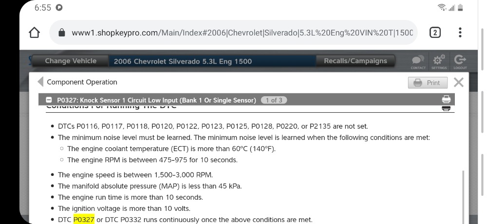

Thank you Noah, could you please guide me a little bit more in deep?
Following, an example of what i can extract from Mitchel for 94 Buick Roadmaster P0101 code. "PCM monitors the MAF sensor frequency and can determine if sensor is stuck low, stuck high, not providing the airflow value expected for a given operating condition, or that the signal variation expected during normal operation is not present.
This test checks for a stuck MAF sensor signal. If MAF sensor frequency varies less than a predetermined minimum amount, DTC will set."
I would like to find something about "That given operating condition". For instance:
*ECT above 185F
*Vehicle speed at about 45MPH more than 2 minutes
*Heavy load
*TPS above 70%
*Then if frequency is below XXX KHz, the code will be set like "pending" for the next 3 cycles and on the fourth cycle, MIL will be set ON

Unfortunately, it's going to be hit or miss depending on the information available.
For that particular vehicle and that particular code, the service information I have available to me has virtually no code set criteria.
I find that is pretty common of pre obd, even pre CAN vehicles.
A better example from something I worked on last week is this 2006 Silverado with a knock sensor code:
Another service information might provide more information on the example you choose considering the Buick, it may not.
You don't know what you won't know until you know.
