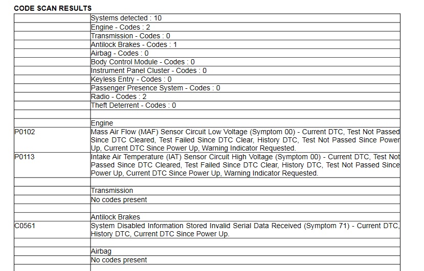

Hey Gary! The GM designations for current and pending are a little weird on Snap-On products. I dunno what you saw on your solus, but this is an example of a code scan from an '07 Pontiac G6:
In the frigging paragraph following the code definition, it indicates that both the MAF and IAT codes are current and history. The 'Test Not Passed Since Power Up' part is especially cool - this code happened since the last time the key was turned on.
Of course, if you're still unsure, you can always hop over to Global OBD on the Solus.

Tyler,
That is pretty much the same type of stuff I was seeing, I did take a look tonight in the OBD Health Check, before tonight I has always looked in ODB Direct side, in the Health Check it explicitly says "Pending" in one of the sections.

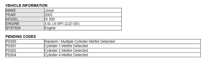

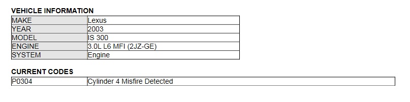

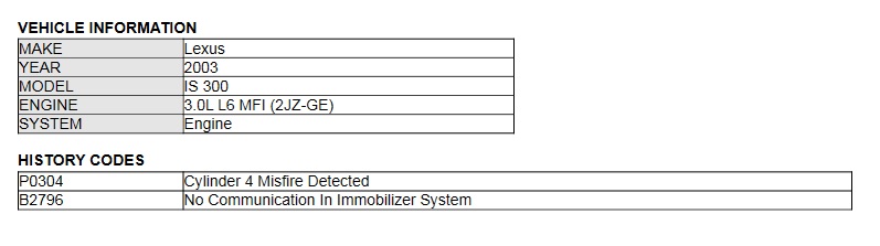

9 years 8 months ago #6884
No worries! I like that article you found, too.
Reading it reminded me about how Toyota/Lexus products list their codes on the OE side. They've got three different menus for each type of code, like so:
Nice that they section it off, but time consuming to check each and every one to get all the codes.
:lol:
